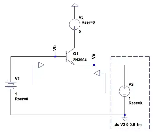

I'm trying to plot a single NPN transistors's own input and output resistances in common emitter configuration looking into the base from input and emitter. I showed below with arrows that the plot I'm trying to achieve is how the input impedance and output impedance varies with Vbe:
So the collector voltage V3 is fixed at 5V. The input voltage V1 = Vb is fixed at 1V. And what actually varied in DC sweep is the emitter voltage Ve. So this causes the Vbe to vary between 300mV to 900mV as follows:

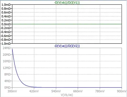

To see the dynamic input resistance the green plot is D(V(Vb))/D(I(V1)); and for the output resistance(seen as shown in the right arrow) it is D(V(Ve))/D(I(V2)).
Is this way of plotting correct? The green plot is almost zero regardless of Vbe. Is that expected?
And here below is if I don't use derivatives:
I'm confused which plots really represents the input output resistances.

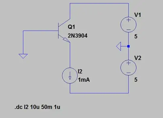

I use this circuit:

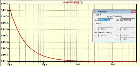

And \$\large r_{e} = \frac{d(V_{BE})}{d(I_E)} \approx \frac{V_T}{I_E} \approx\frac{25.86492 \textrm{mV}}{I_E}\$ plot at \$27^{\circ}C\$

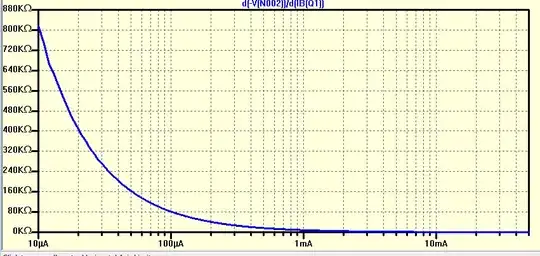

And \$\large r_{\pi}= \frac{d(V_{BE})}{d(I_B)} \approx (\beta +1)r_e\$ enter image description here

  • This looks very good! Is this correct about your jargon?. rpi is the dynamic/AC input resistance looking from the base; and re is the output dynamic/AC resistance looking from the emitter or load. ? – cm64 Jan 16 '19 at 14:44
  • Yes, you are right https://electronics.stackexchange.com/questions/367321/confusion-about-the-meaning-of-re-and-r%cf%80/367430#367430 – G36 Jan 16 '19 at 14:46
  • I plot your answer with respect to Vbe and found out that at Vbe around 700mV, the rpi is around 5 Ohm and re is 1.5k Ohm. This model looks very nice to see the effect of load to input and output impedance. Thanks – cm64 Jan 16 '19 at 14:50
