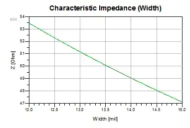

It looks like two simulators you used bracket the value given by FEM simulation of the stackup described in the OSHPark documentation.
Impedance vs Width
Here is a simulation of the characteristic impedance of your microstrip structure swept over trace width.
You should remember, as some of the comments on your question point out, that there will be some variation in the geometric parameters of your board during fabrication including changes in line width and prepreg thickness.

  • This is really useful, thanks for posting this. It still doesn't quite explain the discrepency between the various sources, but maybe the answer to that is this is really a task for a simulator and not approximate equations. – MattHusz Jul 25 '19 at 04:27
