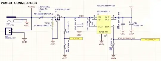

I finally put together this circuit:
Power switch circuit On the input I expect a 5V supply.
I use a voltage divider (VJACK/2 = VSENSE -> going to a 3.3V uC input) to know if there is voltage at the DC jack (V-SENSE goes to a uC pin), and if there is enough voltage, I want to enable the power switch (AP2501M8-13 active LOW) in order for it to deliver the power for the rest of the circuit. Also, I'd like to detect if there isn't power (the DC jack was disconnected, or no voltage in the power supply), and in this case, disable the power switch.

The problem I am having is that after unplugging the DC jack, I still have 5V in VIN and VJACK, so I can't detect with the micro controller a disconnect.
After unplugging the DC JACK, with the microcontroller, I enable and disable the power switch (EXT_POWER_EN line), and I still have 5V at the input. I would think that after disabling it, the input of the switch would go to 0V, dischargin C10 through R7 and R8.
I don't know if it's the power switch, that is bi-directional, or that it is not meant to be used like this, or that the 5V are leaking from somewhere else to the input, but I can't find the root of the issue.
I removed the C10 capacitor, to check if the problem was that it got charged, and could not discharge, but the problem persists without C10.
EDIT: Also, after connecting and disconnecting the DC Jack, if I touch VIN with a jumper wire to GND, it stays on GND, it doesn't get back up to 5V.

  • The problem that you are having is that as soon as MOSFET Q1 is turned ON, there is always voltage at the input side of the MOSFET. The way that I deal with this problem is to insert a low-value resistor in series with the output side of the MOSFET and monitor current flow. – Dwayne Reid Jan 14 '19 at 18:31
  • Hey Dwayne! Q1 is only a reverse voltage protection. When I say input and output, I refer to the power switch (U2).
    5V line in the output of the power switch, are connected with the USB 5V.
    Then, when USB is connected, I get 5V at the input of U2 (VIN), until I connect this line to GND with a jumper wire.
    – sanotronics Jan 14 '19 at 19:33
  • At which node is USB power connected to? – Dwayne Reid Jan 14 '19 at 20:24
  • +5V at the output of the IC U2 – sanotronics Jan 14 '19 at 20:40
  • Please try using a variety of resistor values and momentarily putting a resistor between "Vin" and ground. In other words, use a resistor instead of a short. Please modify your question with the results of that test. I would try resistor values starting at 10k and going lower as much as necessary. That is: 10k, 1k, 100R, 10R, etc. – Dwayne Reid Jan 14 '19 at 23:37
  • I did try this, and none made it. Only a short makes it go back to GND :/ – sanotronics Jan 15 '19 at 19:53
