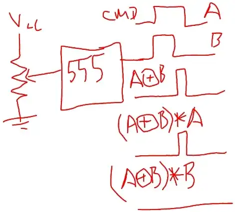

I think this falls into what Horowitz and Hill might call "hybrid" and not necessarily analog, but here goes:
Let's say you have a PWM signal in to control the position of the servo (A), and a pot on the servo, used to control the Pulse width of a timer circuit (like a model aircraft servo) whose output is B.
You use simple XOR between the command pulse and output pulse to determine any error (A xor B). The output pulse will either be the same width (zero error), wider than, or narrower than the command pulse. Then, (A xor B) AND A and (A xor B) AND B will represent PWM signals for CW and CCW rotations that you can use for servo control --- invert the appropriate channel (in the analog sense, i.e., x -1 ), sum them (only one of those signals can be non-zero at a time), and use it as an error signal. Or, just use each channel directly to drive opposite legs of an H-bridge.
A few details left hanging, like matching the gains of the command PWM to the output PWM and such, but this is the general approach (with a cartoon for the pulse width setting on the 555-- you'll need a real timing circuit for a 555 in monostable mode w/ variable pulse width).
sketch
But I agree, a satellite ucontroller might be the fastest route. I think the analog/hybird approach has more panache! It certainly embeds at a very different level-- when you do this, your servo is just looking for a pulse-width in, and other than that stands alone. It might serve as a better "building block".
