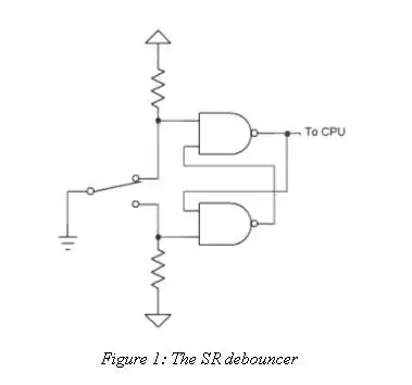

The Set-Reset (SR) latch mentioned by stevenvh is discussed:
SR debouncer

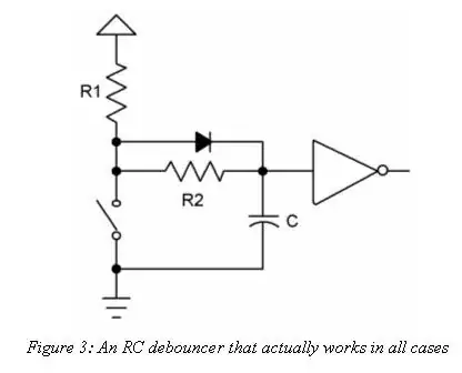

As well as the cheaper RC method:
RC debouncer

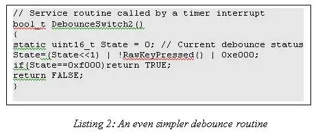

But, as mentioned in the comments and other answers, if you have a microcontroller, you're probably better off doing it in software. The guide also discusses various algorithms that can be implemented.
From a very simple ISR:
simple ISR

You can debounce the switch with a capacitor, but since you're using it with a microcontroller it's cheaper to do it in software. I usually have a 32 ms (software) timer for keypad scans, and only accept a state change if it persists during two consecutive scans. That means you'll have a delay of maximum 64 ms, but since the button will be manually operated you won't notice such a short delay.
You mention a SPDT button, and that's the best solution if you want to do it in hardware.

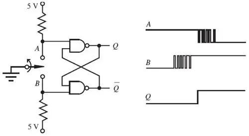

All dry* mechanical contact switches bounce. The amount varies.A SPDT switch is almost always break before make so staes are low / opemn / high.
You CAN get make before break SPDT switches but even those can bounce.
*Mercury wetting is used in some relays to improve current handling capability. I think these may tend to be bounce free but I have had no real-world experience of them, and they are rare and mercury wetting will not be found in had operated switches.
Software will debounce anything - time taken depending on how ultra-violent and ongoing the bounce is.
A Schmitt triggered input with suitable RC delay usually does a good job of debouncing. Bounce is possible if delay is too short relative to worst case boune times.
