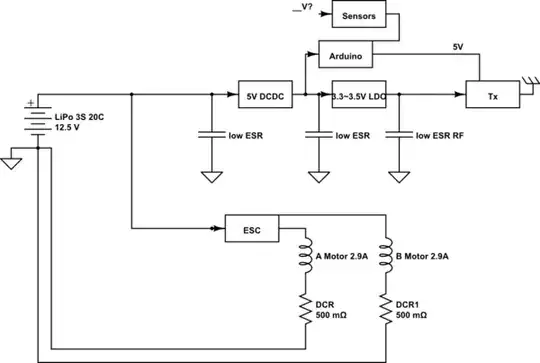

Suggested Incomplete Block Diagram
schematic
  • 4A 5V DCDC looks good,
  • any 3.3 to 3.5V LDO is ok.
  • Sensor V TBD
20C 5.2Ah Battery means can handle 104A surges. Each motor surge is 25A for 3S.
  • ESC and motor wires must be twisted pairs and low R reduce stray current noise coupling to sensors that may need twisted pairs at right angles and/or separation.
Battery Notes also indicate... do not exceed 50% DoD on 1st 5 uses and do not exceed 80% DoD after.
Suggestion
Alternative is use 3.3V Arduino with mods and 3.3V DC-DC converter with RC - low pass filter to Tx to reduce ripple.

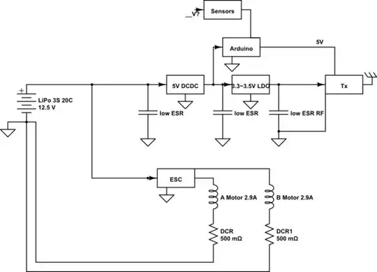

  • How will you control Arduino?
  • How is Arduino connected to ESC?
schematic
20C 5.2A Battery means can handle 104A surges. Notes indicate do not exceed 50% DoD on 1st 5 uses and do not exceed 80% DoD after.

Most electronic systems need to communicate and control, back and forth between the various modules of the system. This means charges flow back and forth.
These charges need a return path, and by convention the GROUND wires provide that shared path.
Some systems use Fiber Optic communications to avoid this "sharing".
