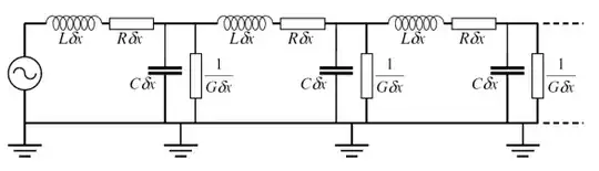

Transmission lines can be modeled as some inductance per unit length and some capacitance to ground per unit length with some resistance to account for losses. The equations to model this behavior can be found in these lecture notes.
transmission line model
The "residual power" is the stored electric charge in the capacitive section of the transmission line. This is a potentially dangerous charge that exists even after the power has been removed. Similar to the charge found in the capacitors in old TV sets and the flash section of cameras.

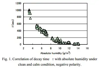

The amount of time it takes for the charge to decay depends on atmospheric conditions (mainly humidity):
The decay time of residual DC charge in a 500kV transmission line had once been measured during five fine and dry days of winter season. The results showed a large scattering without depending on the simultaneously observed weather conditions, such as temperature or relative humidity. Then the authors have performed an additional experiment in a laboratory to discuss the factors that affect the residual dc charge leakage in a dry condition focusing on the moisture in the air and the dusts floating in the atmosphere. It is shown that absolute humidity alone decides the decay time without scattering under clean and calm condition. The floating dusts blown up by the wind, however, reduce the decay time and bring a large scattering. The dusts should be a charge carrier moving freely in the atmosphere.
decay time versus humidity

  • Great answer. Will the residual power be consumed or killed, if a load is connected or by shorting the conductors (with adequate precaution)? Also, I was with an assumption that alternating current will not be stored by capacitors because it gets cancelled out due to alternating nature. – Narayanan Sep 18 '12 at 13:01
    @Narayanan Yes, it is possible to discharge the residual power and there's an app for that. And the residual power is DC. The title of the paper is "Residual dc Charge Leakage Mechanism of a Transmission Line under Fine and Dry Weather Conditions". – embedded.kyle Sep 18 '12 at 13:21
