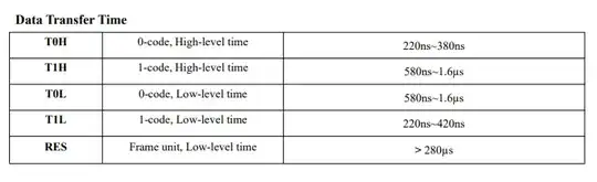

I am having difficulty finding a logic level shifter which translates 3.3 V to 12 V. Data rate is significantly high and hence fast rise and fall times are required. Timings are as below:

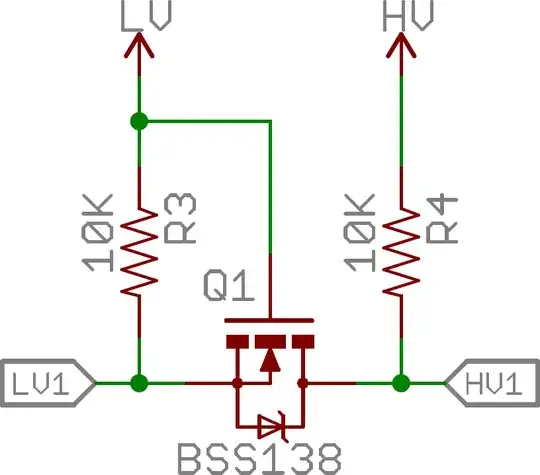

2) I need to implement logic level conversion circuit using basic components. - In this regard, I cam across some circuits as shown below:
logic level shifter
However on further reading, I found that these circuits can't achieve the fast rise and fall times required by ws2815b. Is there a better way which can solve my problem?

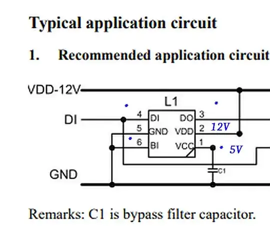

  • @sparky256 - I do understand that it's not barebone LED. It requires command streams for color settings. Page 2 lists absolute max ratings where 9.5V to 13.5V is mentioned. I believe it means the strip needs 12 V as supply. On page 3 however, it mentions electrical characteristics. In parenthesis, it mentions VDD as 4.5V to 5.5V and then logic high is mentioned as 0.7 VDD. This is what is confusing me. – Whiskeyjack Jan 08 '19 at 06:51
THe WS2815B operates on Vcc= 5V supply logic levels from 0.3 to 0.7 x 5V not the LED 12V supply. This means it is similar to the 5V CMOS Schmitt trigger input.
The LED supply is called \$V_{DD}\$ and intended for automotive 12V supply voltages or +9.5~+13.5
The Din Data port operates off \$V_{CC}\$ which is internally regulated and brought out for a Cap to added as an option. Check Pin1. It must be 5V.
Pins 3,4,6 are 5V logic level signals. BI on pin 6 is grounded only on the 1st chip.
The datasheet is a bit unconventional lacking in some details, so this confusion is expected.
They could have included something like this. enter image description here
Perhaps they assumed too much.
The chip ought to have diode clamps to internal 5V on the input from the 10k Pullup you used.
Your design looks ok except the pullup should be to pin 1 = 5V
Depending on the cable capacitance the 10k may need to be lowered towards 1k.
