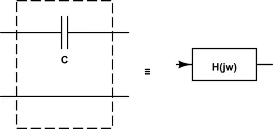

This is more a completing note than a full answer, since Spehro Pefhany and crasic have already detailed the main characteristics of main types of ceramics capacitors. However, they left out a topic which was known in the circle of Audio Electronics Engineers up to few years ago: ceramics are dispersive dielectrics (as practically all existing dielectrics except vacuum, but) whose permittivity varies consistently between \$1\mathrm{Hz}\$ and several \$\mathrm{kHz}\$.
Even if you manage to find reasonably temperature and applied voltage independent ceramic capacitors you may face this subtle problem: the capacitance of those devices, while constant and stable for frequencies above \$1\mathrm{MHz}\$, can change significantly in the audio bandwidth.
Why is this a problem?
As perhaps almost anything in this world, a capacitor can be though as an object with a well defined transfer function:
schematic
The transfer function \$H_c(j\omega)\$ of a ceramic capacitor has the following phase characteristic $$ \arg \big[H_c(j\omega)\big]= \begin{cases} jk\omega & f>\text{few $\mathrm{kHz}$}\\ jp(\omega)\neq jk\omega & f\text{ is below the above limit} \end{cases} $$ where
  • as usual \$\omega=2\pi f\$, where \$f\$ is the frequency of the input signal,
  • \$k\$ is a constant, sometimes called the phase delay
  • \$p(\omega)\$ is a nonlinear (usually odd) function of \$\omega\$ asymptotically tending to the linear function \$k\omega\$ as \$\omega\to\infty\$
This implies that, in the frequency range where the phase characteristic of the transfer function is non linear (i.e. the dielectric permittivity is not constant, in our specific case), the different spectral components of the input signal are delayed in a different way, depending on the value of \$p(\omega)\$.
This thus implies that such capacitors should not be used in the frequency range where the dispersive behavior of their dielectric is more emphasized: as a consequence, it is better to avoid using ceramic capacitors on the signal path of low frequency audio signal circuits
