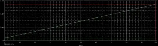

When I simulate the circuit on (OrCad) I got an output voltage between (0 to 1) V changing with temperature . but when I connect the circuit I got the output voltage = -1.85 in minus and different from simulation value , so where is the problem .
and I am sorry about my weak language the circuit
the Vo orcade simulation values

There is basically nothing wrong with your circuit (0.00~1.00V out for 0~100°C), conceptually, except the variations between the models and reality (and the variation between samples of a given BJT) will make a complete mockery of your 5 or 6 digits of precision calculation of the resistors.
There does appear to be something wrong with your implementation, but ignoring that for the moment--
I would suggest replacing R1 with a ~500 ohm resistor in series with a 500 ohm trimpot. Replace R4 with a ~400 ohm resistor in series with a 500 ohm trimpot.
Center the two pots. Put the sensor into an ice-water slurry and adjust R1 to get 0.00V out. Put the sensor into boiling water and adjust R4 to get 1.00V out. Because 741s have a lot of Vos you might need to iterate one time or so to get the maximum accuracy.
