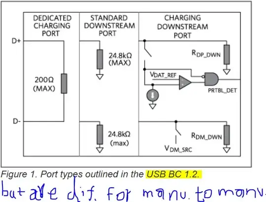

Bus powered means device that only use Vbus of USB for it's power supply. I want to use micro USB as my board power supply. The is designed to take 600mA by 3.3v regulator. But I just don't know how to behave to it's pins? I have found somewhere that, it's data pins must shorted or connected together through 0-200 ohm resistor.
What and why must be exactly it's resistor?
How must be behaved to it's "shield" and "ID" pins? GND must be simply gnd isn't that?
how it will behave to charger and PCs?

    You're over thinking this. For 600 mA draw and personal use, just wire it up and be careful that you only plug it into "charger" supplies of sufficient rating. Pretty obviously you are not making a product to sell to others, or at least you should not be as are nowhere near ready to do so. – Chris Stratton Dec 22 '18 at 23:20
  • @ChrisStratton Yes this is prototype for learning, But if I connected it to PC USB then what will happening? this will go to suspend mode, isn't? – mohammadsdtmnd Dec 23 '18 at 10:48
This is a bit of misunderstanding. The short between D+ and D- (resistor less than 200 Ohms) is the signature of USB Battery Charging 1.2 Dedicated Charging Port on the SIDE OF CHARGER. On device (consumer) side you don't need this. In best case you should attempt to detect the short in order to determine if the port is capable of charging above the default USB power (500 mA or 900 mA).
ID has no relevance in the case of device, and shield can be safely tied with ground.
If your device consumes up to 600 mA at 3.3 V, you can design a switching-type voltage regulator (SMPS buck converter) instead of LDO. The SMPS will transform consumed current, so on the 5-V side it will consume under 500 mA (accounting for 85-90% efficiency). In this case you should not worry about USB port limitations, and your device will be happy with nearly any USB port.

  • Thx for answer. (1) you mean: D+/D- wiring is in supply(charger or PC) side and states how it can provide a current to the device. Finally there is no beacon in the device to tell the supply: I am compatible for XA of current? (2) Is there any recommendation for state of "ID", in charger mod, to float it or resistor/short it to gnd/vcc? – mohammadsdtmnd Dec 21 '18 at 08:33
  • @mohammadsdtmnd, (1) - yes, bur not sure what your "XA" is; (2) ID pin in classic USB is always an input, it was meant to discriminate between micro-A and micro-B type of plugs, and was never "propagated" from source to destination, unlike CC wires in newer Type-C connection standard. Leave ID unconnected. – Ale..chenski Dec 21 '18 at 20:11
See this post, in short it is for fast charging. This is beyond the original spec of 500mA for USB so YMMV.
