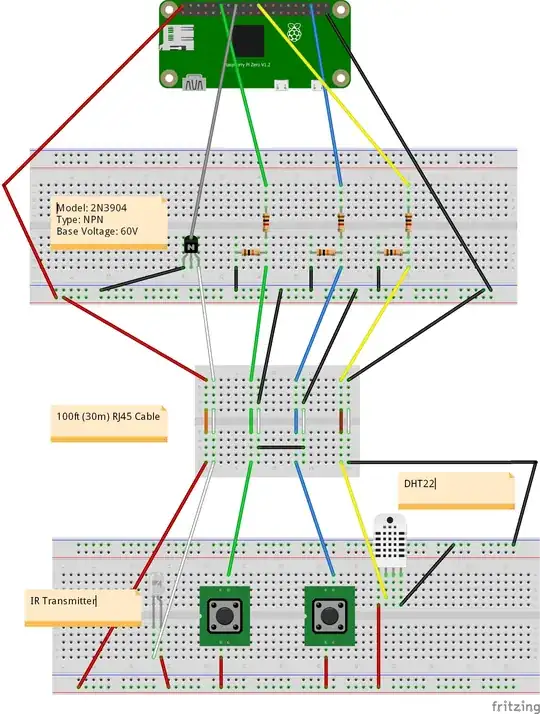

I've drawn my wiring to fitzing to explain it. See below. Some notes to take into consideration:
  • For the RJ45 in the drawing, assume the white wire is partially colored of the closest wire on it's left. For exemple, the first wire is orange, and the second one is white-orange.
  • For the resistor, horizontal ones are 10k and vertical ones are 1k.
  • white-green and white-blue are not used, so i merged them on one end and put them to GND on the other end. Before doing that, I had interference between IRLed and button switches
fritzing schema schematics

    While the wiring setup is nice to show how a mess this is to wire up on breadboard, it's really hard to follow. Please also supply a schematic. – Marcus Müller Dec 09 '18 at 22:49
  • If you have the controller and sensor 3m apart and have 30m of wire to test, you may wish to spread the wire as much as possible for testing rather than having it be a coil on the floor. The more it runs parallel to itself, the more stray inductance/capacitance you'll have to deal with. In your use case it will probably be spread out full length anyway. Often when a system requires arbitrarily long wire for sensors and such (seismic, oil work, industrial), the equipment is designed to use current mode communication rather than voltage mode. – K H Dec 09 '18 at 23:00

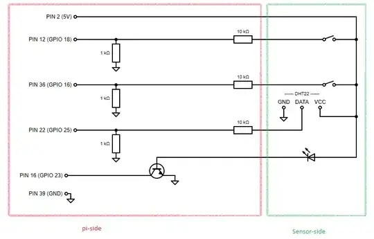

    @MarcusMüller I've added schematics, I hope I got it right. – ericmas001 Dec 10 '18 at 04:04
  • @KH you're right, during test i'm using a rolled 30m cable, but it will probably be spread out 20m when final. I will try spreading it out to better represent my use case, thanks ! – ericmas001 Dec 10 '18 at 04:07
  • @ericmas001 that schematic is well-done! Thanks! – Marcus Müller Dec 10 '18 at 09:15

Your sensor isn't meant to drive meters of cabling. That's simply not what it was designed for.
The idea to use Cat6 cabling is good, and I can see that it comes from the realization that ethernet over such cable works over long distances, too.
However, in ethernet, the twisted pairs of the signal lines are driven differentially (i.e. the current on one conductor is the opposite of that on the other, and at the receiving end, the difference between potentials is evaluated), and great care is taken to ensure the signal is robustly read and reconstructed.
Your circuitry has no measures whatsoever to fulfill the same role, so it simply doesn't work over a long distance of cabling, where you simply lose a lot of voltage to ohmic drop over distance, where you get the full length as antenna or secondary winding to a parasitic transformer with the power grid, and, most importantly here, where you take no steps to help the transmitter drive the capacitive and inductive load that the long wire represents.
For this to work, you'd need to change a few things:
  • long runs of twisted pair really aren't good for low-voltage power transfer. Use transformers to step up your voltage at the feeding end, and step down at the receiving end.
  • You'll need single-ended-to-differential conversion at the sensor end, and the opposite at the receiver end.
  • You'll need to match the impedances.
  • Not quite sure what the voltage divider in the sensor's data line does – but it does look to me like unnecesary load to the sensor. However, this will be obsolete by itself when you use the differential transceivers
  • I don't know what speeds you need from the IR transmitter – but it was a good idea to use something to increase the drive strength of your Pi. However, instead of using a transistor at the transmitting end only, you'll want a schmitt-trigger buffer + drive transistor at the receiving end, or go for differential transceiver + driving transistor right away
  • This all considered, it's usually simpler to go and have a small microcontroller at one end of such a long line that does all the local interfacing, and only needs a single link over the long distance. If you go that route, you could probably even just use I²C instead of differential transceivers; low-speed I²C is relatively robust, and all non-least-cost microcontrollers come with I²C masters integrated, and the Pi can also act as I²C device; there's even kernel drivers.
  • If you want to try I²C: there's actually sensors other than the slightly underdocumented DHT22 (where do people even find these things?!) that speak I²C themselves (example temperature sensor, example humidity + temperature sensor). That would save you quite a bit of trouble, as you could, without any further ado (actually: maybe a pull-up resistor) attach that thing to the Pi.
  • If you actually want to do it like the "big kids": Industrial sensors typically are just supplied with a constant current (somewhere in the 4–20 mA range), and you'd read out the value by the voltage drop across sensor + cabling. Current loops are insensitive to cabling resistance.

Raspberry Pi GPIO should register 3.3V for a logic 1. Assuming the impedence looking into Pin22 GPIO 25 is infinite, Pin 12's voltage is a voltage divider.
1/11 or 1K/(1K+10K) of 5V = 5/11 = 0.45V << 3.3V (yikes!). Choose R2 (pull down resistor) that provides 3.3 volts and not 5/11 = 0.45V
Seek: R1/(R1+R2) = 2/3
If we keep R2 = 10K, then change R1= 20K Ohms
This analysis does not take into the account the voltage drop caused by the length of the CAT5 or similar cable (RJ45 is the spec for the end of an 8 wire data cable). That being said cable voltage resistance is 1000X less than 10K, then it becomes negligible
gatorback
  • 219
  • Hi, i'm trying to make sense of what you said and i'm pretty sure I understand, the only thing that makes less sense to me is why you are specific about pin 12 having a voltage divider and why is it relevant here (since pin22 and pin36 have the exact same divider and pin12 is no more linked to the DHT22 than pin36). Forgetting about this confusion, I got that if I change all my R1 to 2K and all my R2 to 1K, i would have 3.3V instead of 0.45V on my 3 "data" pins, and that would probably eliminate my problem – ericmas001 Mar 18 '20 at 02:16
