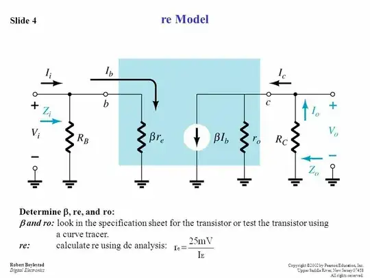

This is a picture of a Common Emitter Voltage Divider bias and it is been modelled using a CCCS and a diode resistance using the r_e model. Now my doubt is that I get problem in finding the input impedance/current and output impedance/current for the above model. How should I approach and how should I think and apply which techniques? What should I do so that I don't need to memorize and model the transistor myself for different configurations?

I can also see that input impedance is R1 is parallel to R2. But my problem is how to find input and output current. – John Cena Nov 30 '18 at 05:32
You have a circuit on the left and a linearized (which means it only works at a specified DC operating point) model for the BJT, without the circuit, on the right. You can't compute the DC base current from the model for the BJT. You can compute the DC base current for the circuit on the left. But why do you bring up an AC linearized BJT model (on right), applicable for AC analysis only, when discussing a DC operating point (on left?) – jonk Nov 30 '18 at 05:38

Oh my god. I put the wrong image of DC. Sorry, Here's the right image of AC Analysis. I have no doubts regarding DC Analysis. – John Cena Nov 30 '18 at 05:55
1Are you aware that you are *only* using the linearized hybrid-$\pi$ model? You need a DC operating point. That is, in some sense, specified by the value of $r_\pi=\beta:r_e$ (or else $r_e$.) That's an input to analyzing with the model. Not an output of it, as I understand things. $\beta$ is another such input. – jonk Nov 30 '18 at 05:58

You have an unloaded CE amplifier.
DC Biasing gives you \$I_E\$, which allows you to determine \$r_e\$.
You would probably be given a Table for input impedance \$Z_i\$, output impedance \$Z_o\$, voltage gain \$A_V\$ and current gain \$A_I\$ for the variety of biasing circuits your instructor expects you to cover.
In the CE \$r_e\$ model, there is no connection between input and output. So Input impedance is: $$Z_i = R_B \parallel \beta r_e$$
Output impedance looks back into circuit with 0 input.
$$Z_o = r_o \parallel R_C$$
If \$r_o\$ >> \$R_C\$ (by a factor of 10+) then output impedance can be simplified to:
$$Z_o \approx R_C$$
This simplification can be made because the Q-Point will vary with \$\beta\$, temperature, tolerances.
Voltage Gain (from a formula sheet).
$$ A_v = - \frac {r_o \parallel R_C} {r_e} $$ $$ A_v \approx - \frac {R_C} {r_e} ,\ if\ r_o >> R_C$$
You can use \$Z_i\$, \$Z_o\$, and \$A_V\$ to form the Generalized Model to simplify solving currents (but that is not your question).
Use current division with the \$r_e\$ model to solve for currents.
$$ I_b = I_i\ \frac {R_B} {R_B + \beta r_e} $$
That gives you \$\beta I_b\$.
\$I_o \approx \beta I_b\$ or:
$$ I_o = \beta I_b\ \frac {r_o} {R_C + r_o} $$
