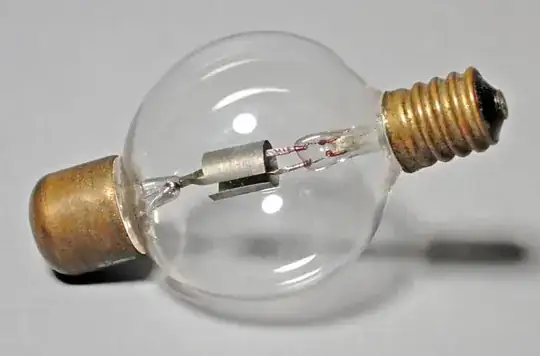

This is a diode:
diode tube
Image From uv201.com
It is a vacuum tube with two terminals (not counting the heater). Much like a triode is a three terminal vacuum tube.
The cathode emits electrons by thermionic emission, and those electrons are only attracted to the anode if it is at a higher voltage, meaning it rectifies the current flowing through it.
Fifty years later a semiconductor device with the same purpose was invented.
