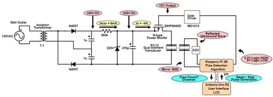

Here is my current schematic: Pulse Generator Schematic

Since the RF is 5MHz, that gives us a cycle time of 200ns. I've learned that the way these transducers typically operate is through a high voltage pulse of 1/2 cycle or less. This is referred to as pinging the device. So the goal of the pulse generation circuit is to provide a 100ns pulse at 220V amplitude.
My progress was going fairly well until I began thinking about how I'd be switching the pulse on and off again. I thought I could use a simple spst switch at first, and quickly realized that I was deluding myself. It seems that the only solution I could find was using a Power Mosfet.
I researched many different potential devices, as well as the parameters on the datasheets that would be the most important. I found that in order to get as close to 100ns pulse width as possible, I'd need to minimize both the Gate Charges (Qg,Qgs,Qgd) and Delay Times (tf,tr,td(on),td(off)). One potential device I found was SiHP6N40D, http://www.vishay.com/docs/91498/sihp6n40d.pdf.

The next step was to interface the switch with my microcontroller so it could control the sampling rate. I realized the gpio output wouldn't be high enough to meet the Vgs of 10V, and additionally it would be too dangerous to directly connect my Raspberry Pi gpio pins to the power mosfet due to capacitance leakage through the gate. The solution for this was to use a gate driver, which in turn has its own delay times.

And it was at this point that I reached a threshold of confusion that I felt I needed to get help with. I don't know how to achieve my goal of a 100ns pulse width since there are so many factors to consider: mosfet delay, gate delay, microcontroller toggle speed. And ontop of that, I'm fairly certain now that in order to activate the mosfet gate, Vgs = 10V does not mean 10V is applied to the gate, it means that I would need to apply 230V. Applying only ~10V would put the mosfet into forward bias as according to this post.
In summary, I'd like help with figuring out how to go about approaching this to ensure I get as close to 100ns as I can. Also, if there are obvious problems that I haven't mentioned please inform me of those. Ultimately, if it isn't possible to get near 100ns, I'd be okay with simply being able to send A pulse to the transducer.
Component Calculations:
I've chosen to go with a sample rate of 2kHz, and used that to determine the components in my circuit schematic.
Since the capacitor should be almost fully discharged in 4 time constants (~98%), and I want the pulse to be 100ns
τ = 25ns.
C = 25ns/(50ohms + 1ohm) = ~490pF --> 470pF
*Where 50ohms is the impedance of the transducer and 1ohm is the Rds(on) resistance of the mosfet.
We'd want the capacitor to be charged in less than 1/2 of a cycle of the sample rate, or 250us.
R = 250us/470pF = 530kohm --> 560kohm
The current leaving the capacitor upon switching of the mosfet starts off high
Vc(1ns) = 220V x e^-(1ns/(470pF x 50.32ohm)) = 210.89V
dV/dT = (220V - 210.89V)/1ns = 9.11E9
ic(1ns) = 470pF x 9.11E9 = 4.28A
At the end of the desired time the mosfet should be open, ic would be
Vc(100ns) = 3.2V
dV/dT = (220V - 3.2V)/100ns = 2.168E9 V/s
ic(100ns) = 470pF x 2.168E9 = 1.02A

  • "so many factors to consider: mosfet delay, gate delay, microcontroller toggle speed" You generate a repeatable waveform, delay of transmission and gate drive, just generate a time shift in signal and you have signal properly. – M KS Nov 18 '18 at 17:37
  • I think that I have just had an epiphany. Since the Nmos needed 230V to activate the gate, can I simply flip the Nmos horizontally so that the source is now on the low side in terms of voltage? That would seem to Allow the 10V output of the driver to open the gate now. If this problem was really that simple, this is what happens when you spend an extended amount of time working on a single project guys! – snowg Nov 19 '18 at 08:34

    You used resistors. Where you meaning to use a transformer? – Edgar Brown Nov 18 '18 at 17:39
  • @snowg You should place optocoupler between your IO and gate drive, even your circuit change with this one. – M KS Nov 18 '18 at 17:45
  • I've been working on the enclosure for the device. When you say 'all grounds', would that include the neutral wire from the isolation transformer, and the ground node of the pulse circuitry? – snowg Nov 18 '18 at 18:14
  • I see how this example fixes my problem. Would the voltage being present on the transducer, but no current flowing, cause any ultrasound to be produced though? – snowg Nov 18 '18 at 20:55
  • Avoid any transformers or optical isolators, because of possible asymmetric time-delays. Pick a gate-driver with balanced delays. Regarding no current flowing, there will be no energy input to the transducer. If worried, place 1MegOhm across the transducer. – analogsystemsrf Nov 18 '18 at 21:01
  • RegardingGrounds, I'd not connect to the primary side of the power transformer in any way. And yes, the ground node of the pulse circuitry should be connected; please provide full details on what you are planning to connect to ground, so stackX experts can review your ideas. – analogsystemsrf Nov 18 '18 at 21:04
  • For resonance, apply a narrow pulse (your 200 volts) for about 1/4 period (that is, during the first 90 degrees of the ringing). Just a thought. – analogsystemsrf Nov 18 '18 at 23:25
    @analogsystemsrf , you said "Avoid any transformers or optical isolators", I don't know the source power of Arduino and RPI board, the schematic shows MCU Gnd, I think the ground of MCU and resonator circuit may have different voltage so the isolation is required. isolator like Adum1200c is fast enough in both rise/fall time. (ISL55110,MD1213DB1 has no isolation) – M KS Nov 19 '18 at 11:31
  • You are correct. I have since purchased an isolated gate driver from TI. UCC20520DW, http://www.ti.com/lit/ds/symlink/ucc20520.pdf. I have trouble understanding the many parameters on datasheets occasionally. Confirmation that this would work in my circuit would be appreciated. – snowg Nov 22 '18 at 19:04
