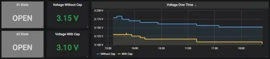

I’ve now built two prototypes of the device with similar components as I’ve mentioned earlier. One of them has a 220 µF, 10V electrolytic cap of the ULD series by Nichicon, the other doesn’t. They are powered with coin cells from Sony, both from the same package.
Unfortunately, I only have a DMM to take measurements, which means measuring currents in the lower µA range won't be accurate. So I tried to get an estimate using a 100k Ω resistor in line with the power source and measured the voltage drop while the components where in power-down mode, which resulted in roughly 9 µA without and 11 µA with the additional capacitor. Those values might be reasonable, but are quite a bit higher than expected regarding the specified values in the data sheets. (Note: I took those measurements while the circuit was still on a (rather large) breadboard.)
Edit: Always doublecheck your fuse bits! After thinking about what could be the cause for those rather high power-down currents, I noticed that I didn't disable brown-out detection via the extended fuse. BOD consumes something between 10 and 35 µA on AVRs, which is a lot if you want to run for years on 220 mAh. Now I'm down to a more reasonable 1.5 µA without and 3 µA with the capacitor.
(Yes, turning of BOD can be bad, but a) the functionality of these devices isn't critical, b) all components are able to run on voltages below 2V, at which point the coin cell is way overdue for a replacement and c) I'm monitoring the voltage constantly remotely and can set a certain threshold (say 2.2V), when the system should send me a push notification reminding me to replace the battery soon.)
Anyways - I’m measuring the voltage via the Atmega’s internal 1.1V reference and transmit that value over the radio whenever the window gets opened or closed and store it in a database. To verify if those readings are accurate, I will also measure the voltage manually with the DMM on a regular basis. Monitoring voltage and state of the devices
Looking at an estimated battery life is difficult as long as the actual power-down currents aren't known. If we assume the measured 9 to 11 µA are correct, I can expect ~ 2 years for both units. (Calculating with a current of 12 mA while active for 100 ms once an hour with a battery capacity of ~185 mAh (220 mAh acc. to the data sheet - 15%). If we assume power-down current are closer to the values stated in the data sheets (2 µA without; 5 µA with capacitor), we're looking at a rather large difference of 4 to 9 years of battery life.
It'll surely take a while to find out whichever turns out to be closer to the truth. I might update this question / add an answer as soon as I have at least an indication whether the capacitor is beneficial or not in my particular case.
