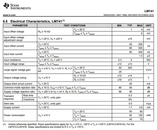

Some of the other answers here draw conclusions from the Maximum Ratings and the Recommended Operating Conditions. Actually these numbers are completely irrelevant. What is relevant is the Input voltage range, source: The TI datasheet.
Note how this is a table with Electrical Characteristics
The Input voltage range is specified to typically be +/- 13 V but it has a (guaranteed) minimum of +/- 12 V. In a commercial (mass produced) design you would use this +/- 12 V as that you can rely on. The +/- 13 V cannot be relied upon. Also very important: note (1) under the table, this lists the operating conditions which must be applied to get the values listed in the table. Important here is the +/- 15 V supply as the Input Voltage Range is very dependent on the supply voltage that is used.
Yep, reading (and understanding) a chip's specification isn't easy :-)

    Recommended operating conditions do not tell us if the inputs can work up to that range as well. Often a +/- 5 V supply will result in a usable input voltage range of perhaps +/- 4 V. What is relevant is the Input Voltage Range which (according to table 6.5 in the TI datasheet: http://www.ti.com/lit/ds/symlink/lm741.pdf ) is typically +/- 13 V when a +/- 15 V supply is used. – Bimpelrekkie Nov 14 '18 at 09:13
