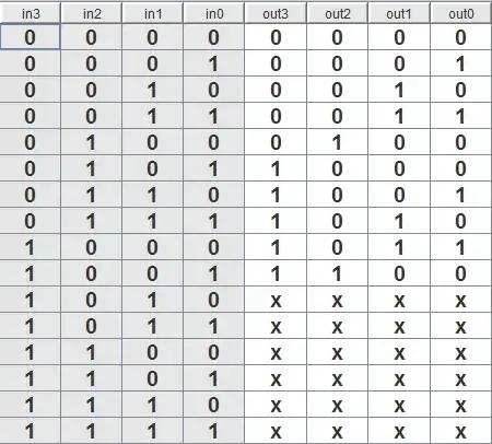

For a combinational circuit, jonk's answer about a double dabble algorithm circuit is good.
To summarize, all you need is a special component and a layout that matches the double dabble algorithm.
double dabble layout
Any 4 bit circuit component that can satisfy the "plus 3 if > 4" property will work. That is, the circuit must satisfy this truth table:
(The x's are "don't care"s, so the circuit can output any value for those)
plus3 truth table

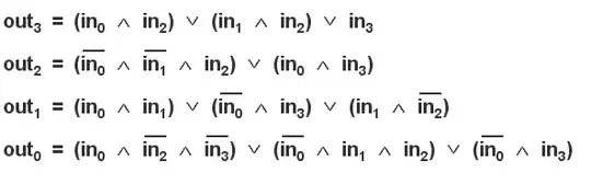

In disjunctive normal form:
plus3 dnf
This may be created with an adder, comparator, and multiplexer:
plus3 with adder
Or you can easily implement the DNF equations. If you're clever you might be able to reuse gates since DNF lists each bit independently.

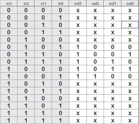

If you include a bit of logic to detect if a number is > 4 or not and add a multiplexer, the equations for > 4 simplify further.
plus3 truth table variation
(Multiple solutions for some output bits)

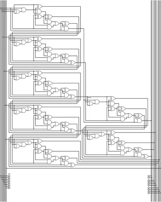

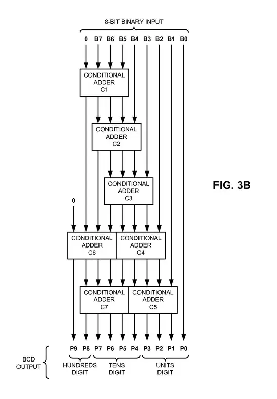

Necro bump, but I just threw this together while researching binary to BCD this evening. This was the first result on google for this topic, so I figured I'd leave this for anyone else looking.
Edit: I seem to have received a negative score. I hope I have not posted something wrong or perhaps there is some social faux pas I have performed.
  • I did not downvote, but you probably received a downvote for posting a diagram with no explanation at all – qwr Jun 27 '21 at 02:51
