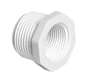

  • PVC Bushings
    Other bushings are a bit more complex in their design. Rather than a simple rubber circle, many bushings have different features that help give a little extra protection or added functionality. Non-metallic wire bushings, for example, are essentially similar to rubber grommets, though they're made from PVC and feature a threaded pattern that allows them to install into surfaces more securely.1

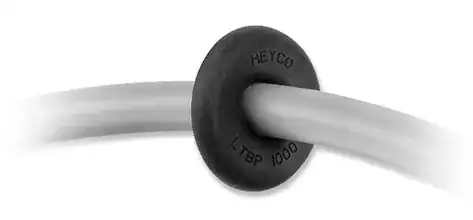

  • Snap Bushings
    Snap bushings are so called because they can snap into the surface and lock into place once installed, thanks to the design of the outer edge that allows portions to expand once placed into the desired hole.
    Many snap bushings are simple circular pass-throughs, but others feature "wings" or "shutters" which are flaps that help keep cables from being too loose in the pass-through, keeping them centered and also protecting them from too much vibration and shock.1

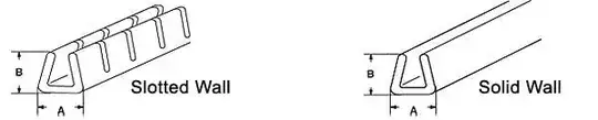

Steve also mentioned grommet strips, also sometimes referred to as "edging", and can be found with or without adhesive.

The bushing from my original question ended up being a Heyco snap bushing SB 375-4 (part no. 2030) with an inside diameter of 0.27" (6.8mm). A complete catalog is available online and parts can be sourced from Mouser Electronics.

  • That PVC bushing of yours is not used like ordinary bushings. It's an inverse spacer, making the hole for the cable gland smaller. That's why it's tapped inside and out. – Mast Nov 13 '18 at 11:01

They are called grommets. You can also get grommet strip.
