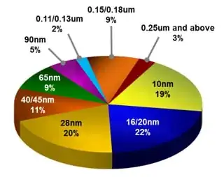

There is one (more) important point which is usually overlooked, process technology.
FPGAs that have high market share are manufactured with cutting edge technology. To be more specific, Kintex-7 FPGAs have TSMC 28nm process and their shipment started in 2011[1]. TSMC had started mass production of 28nm in the same year[2].
[1] Xilinx ships first 28nm Kintex-7 FPGAs (By Clive Maxfield, 03.21.11)
[2] Chang said: "Our 28-nm entered volume production last year and contributed 2 percent of 4Q11's wafer revenue."
I don't know the process of the ethernet switches, but most of the ASIC design companies don't follow the cutting edge technology. It doesn't make sense for foundries as well.
The following chart shows TSMC's revenue by technology (1Q18). Even in 2018, 39% of the revenue comes from technologies older than 28nm. If we think about the number of chips, it is not hard to imagine that more than half of ASICs are today manufactured with technologies older than 7-year-old Kintex-7.
TSMC revenue by technology
As a conclusion, process technology is one of the factors that make FPGAs more expensive. I don't claim it is a dominant factor, but significant enough to be considered.
