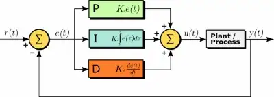

Figure 3. The classic PID control function. Source: Wikipedia - PID controller.
As explained in one of my linked answers below, as the integral action corrects the output the error falls to zero so the contribution of the proportional control also falls to zero. The output when the error is zero is maintained purely by the integral action.
