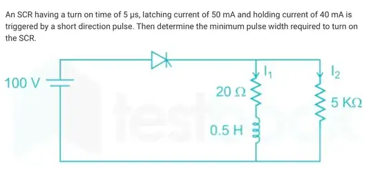

The following question I encountered is asking about the minimum time for applied voltage to the gate of an SCR to turn it ON: enter image description here

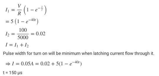

And below is the solution: enter image description here
I can understand the solution looking for the pulse duration for the SCR current to reach 50mA latching current.
But at the same time the question describes a term called “turn on time” which is 5us. But obviously the SCR does not turn on for 5us but 150us.
What is the “turn on time” then if it doesn’t provide us the information about the time taken for SCR to be turned ON?

  • Have you noticed that $I_2$ is purely resistive so you can take it out and consider the latching current to be 50 mA - $I_2$? – Transistor Feb 19 '21 at 20:26

In the case you show above, the calculation shows how much time is required for anode current to rise to the minimum latch current. And the gate would need to be energized for that amount of time (minimum) to keep the SCR on.
