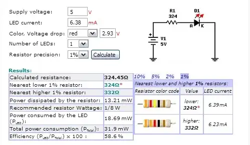

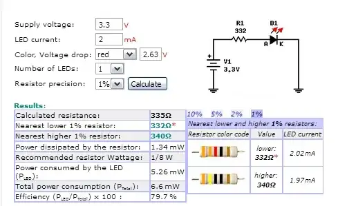

I assume you used the same 325 Ω in both cases.
5V with a 325 Ω resistor and Vf = ≈ 7 mA
3.3V with a 325 Ω resistor and Vf = ≈ 2 mA
plugging your numbers in to a resistor calculator:
Source: LED Series Resistor Calculator

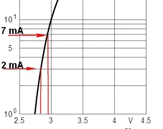

Looking on an IV curve:
2 mA ≈ 2.6 V
7 mA ≈ 2.9 V
Source: OSRAM blue LED

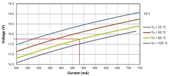

This is easier to show with a high power LED.
Let's say we want to make a flashlight with 1000 lumen output.
We select this 900 lumen LED.
This luminous intensity is measured at 400 mA and 85° C.
This LED's maximum current is 750 mA.
We have to up the current from 400 ma to get 1000 lumens.
1000/900 = 111%
So we go to the Relative Luminous Intensity graph.
Draw a line across at 111%
Draw a line down from the point where the 111% line intersects with the 85° curve.
We see that 475 mA should give us 1000 lumens.
We go to the IV curve and draw a line from 475 mA up to the 85˜ curve.
The draw a line from were they intersect to the forward voltage.
The forward voltage for this LED at 475 mA is 17.75V.
Let's say we are using a supply voltage of 24V.
We go to the resistor calculator and enter 24V supply, 475 mA, and 17.75V for the forward voltage.
So for 1000 lumens we need a 13.3Ω, 5 Watt resistor.

  • Thanks for the diagram. is there any mathematicval formula to calculate voltage drops at different curerrent ? – Anton Stafeyev Oct 29 '18 at 19:08
    No. The way it goes you go to the datasheet select a luminous intensity, get the current for that intensity, then go to the IV curve to the the Vf at that current, then use the Vf and current to calculate the resistor value. . – Misunderstood Oct 29 '18 at 19:23

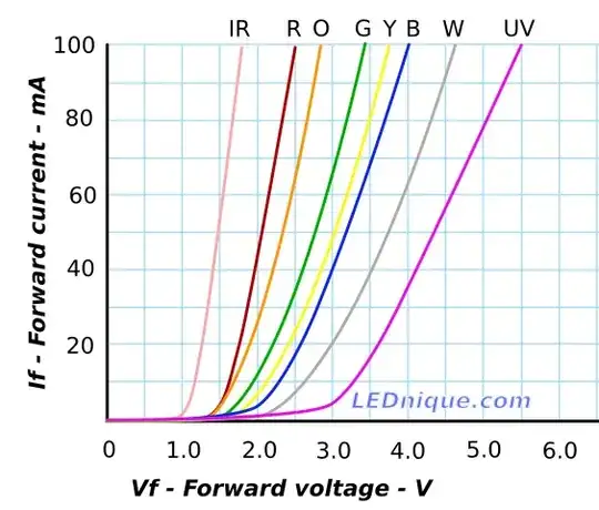

Figure 1. Typical LED I-V curves. Source: LEDnique.
The forward voltage drop, VF, across an LED is not a constant but varies with the current. If we take the blue LED in Figure 1 we can see that at 40 mA it will have a VF of 3.0 V. If we reduce the current to 20 mA the VF will reduce to about 2.6 V.
... and according to Kirchhoff law it would affect my current bacause I am connecting this LED before the resistor.
The order of components in a series circuit does not matter. The same current flows through all of them.
There is also a video on the linked page which shows how to draw the I-V graph.

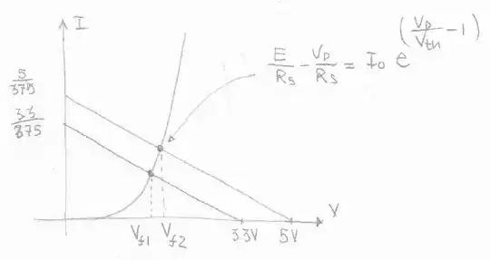

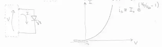

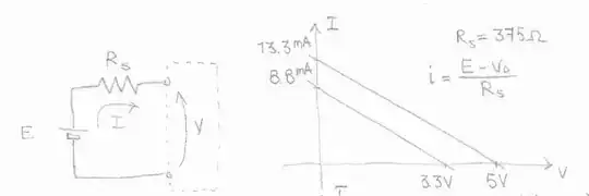

Here's what happens. Voltage generator and series resistance have the following V-I characteristic - note that by changing the value of the voltage, the characteristic shifts. On the V axis the characteristic reaches the open circuit voltage, while on the I axis you have the short circuit current. This is known as the 'load line'.
The diode has the following characteristic (this is a simplified Shockley relation, but you can derive yours from the datasheet)
When you put the two parts together, the circuit will work so as to have the same voltage and the same current in both parts. The intersection of the generator and diode characteristic is the pair Vd Id you are looking for:
As you can see, if you raise the voltage, you move the point of intersection and you end up with a higher voltage drop across the diode. Note, however, that the diode characteristic hasn't changed.
The quiescent point (Vd, Id) is the solution of the system of two equations that describe the characteristic. The nonlinearity of the diode characteristic is such that you cannot solve it analytically (but have a look at this answer by jonk). You can either solve it graphically (by drawing the load line on the curve supplied by the diode manufacturer) or numerically (by hand with an iterative method, or by computer firing up Matlab or Mathematica - you might need to scan the characteristic to produce a model) or, if you are given a Spice model, by using Spice.
