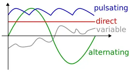

The way I get it, AC and DC are the names of two very specific current flows. They are named, because they are used by far the most often.
Forier transform is a mathematical method to represent any "good" function as a sum of a constant, sines and cosines. That is, any function, e.g. current, can be expressed as a combination of DC and (in)finitely many AC-s with different frequencies and ever smaller amplitudes. This could point out that there is only DC and AC.
However, this transform is not unique. Any set of "independent" (orthogonal) functions can be used as a base to decompose the original signal. Then there is "no" AC and DC.
Why do we use the Fourier decomposition so often? One reason is that sinusoids occur often in physical nature and thus are intuitive.

1But Fourier tells us that (almost) any real-world periodic signal, like your "pulsating", is just the combination of sinusoidal signals, like your "alternating", plus a d.c. component. – Joe Hass Sep 13 '12 at 11:17
2@Joe Hass, consider adding this to the answer if you approve the general idea of the answer. Which is "current can follow any function of time". For if we use fourier, there is no DC, only zero-frequency AC. What's more, fourier chooses sin and cos as a base. Other bases are possible. So there is no AC (sinusoidal current)? – Vorac Sep 13 '12 at 11:28
@Vorac - the Fourier series starts with a term $a_0$/2, which is the average level of the signal, i.e. the DC component. – stevenvh Sep 13 '12 at 13:26
@ Joe Hass, @stevenvh, tahnk you for this discussion. I have appended the answer - feel free to correct or edit it. /off lol - a nice picture always bring a ton of upvotes :D – Vorac Sep 13 '12 at 14:02
"Why do we use Fourier decomposition so often?" --- Because for linear(ized) systems it allows us to solve complicated differential equations using only "simple" linear algebra. – The Photon Sep 13 '12 at 16:32
