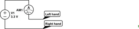

  • @AntonStafeyev One thing to note when measuring something is to make sure that the measuring device is working first. For example, when using a multimeter to measure resistance, touching the probes together should give a reading very close to 0 Ω. It doesn't have to be exact, just good enough. If you mention the make and model of your multimeter when asking a question, we would have a better idea of what sort of measurements we could ask you to make. – Andrew Morton Oct 15 '18 at 18:37
schematic
Figure 1. A simple current measurement.
  • Find a multimeter.
  • Switch it to the most sensitive DC current measurement range. Plug the leads into mA and COM.
  • Connect one lead to +3.3 V.
  • Hold the other lead in your left hand.
  • Touch the 3.3 V common or ground terminal with your right hand.
  • You will not be dead so you can take a current reading from the multimeter.
  • Let go the leads and write down the reading.
  • Is the current greater than 100 mA?
Let us know what you find.
Plug the leads into V and COM and switch back to volts. If you forget to do this before you take your next voltage measurement you may blow the current shunt fuse or destroy the meter.
