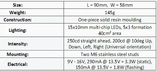

Comparison of the two products you linked
It is not simple to compare two LED when you have the proper specifications. The problem here is the authors of the specifications do not understand photonics.
One is 250,000 mcd @ 0° and 200,000 mcd @ 10° for all 15 LEDs

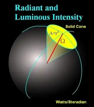

The problem here is candela is a measurement of lumens (lm) per steradian (sr). Where a steradian is the amount of light within a cone of a specified angle.
This candela view angle of the cone has nothing to do with the "off axis angle" chart shown above.
A steradian of 0° does not exist. It has zero light. If you were to convert candela, with a view angle of 0°, to lumens the result would be zero lumens.
Example of a steradian
This product gives the spec for each LED of 5,700 mcd @ 30° for a total of 102,600 mcd for all 18 LEDs @ 30°.
