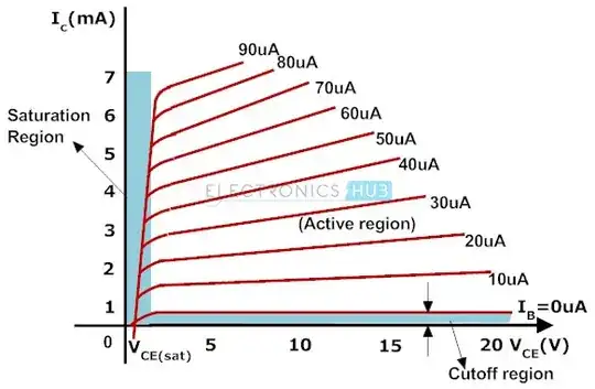

Characteristic Curves
Output Characteristic
For a concerned IB at the start of the curve, it has a speedy variation (relatively high gradient) and after a while the variation is slow and becoming linear(less gradient).
  1. What is the reason for have two gradients? Starting have a speed variation and then slow gradient... I tried to concentrate it with the Ohm's law but couldn't.(According to the ohm's law the R out should different at the two situations.)
Transfer Charasteristic
  1. I can't understand the reason of why there is a saturated region after the activated region. Why does the activated region can't to be continue.

I'll answer the 2nd and 3rd questions out of order:
If the curves for the active region continued to the left of the y-axis, that would be in the 2nd quadrant of the graph. This would require the transistor to provide power to the rest of the circuit. But a transistor is not a power source, so it can't do that.
I've answered this in more detail in response to past questions: 1 2.
Two modes of operation, two different behaviors.
If it's clear the transistor can't continue the active-region behavior into the 2nd graph quadrant, then something has to happen to keep the curve in the 1st quadrant. What happens is what you see in the graph you included in your question.

  • Before the last paragraph, what did you mean by "Two modes of operation". – Osal Thuduwage Oct 07 '18 at 16:54
  • Forward active, saturation, cut-off, reverse active, and reverse saturation are often called the "modes of operation" of a BJT. – The Photon Oct 07 '18 at 17:12
