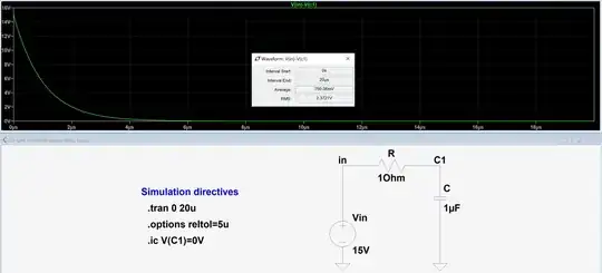

So can one say that the power burnt by the resistor is based on that \$ 0.5CV^2f \$ of energy? The following simulation suggests the same: enter image description here
The green curve is the voltage across the resistor, if you consider its rms value, it is \$ 2.37V_{rms} \$. The average power burnt across the resistor would be:
\$ P_{avg}=\displaystyle{\frac{V^2_{rms}}{R}} \$ ; \$ (R=1 \Omega) \$
\$ P_{avg}=\displaystyle{\frac{2.37^2}{1}} = 5.61W \$
But, if one was to use the expression directly, i.e \$ P=\displaystyle{CV^2f} \$ OR \$ \displaystyle{\frac{(CV^2)}{t}} \$
\$ P = \displaystyle{\frac{1\mu * 15^2}{20\mu}} = 11.25W\$
This is twice of what the simulation suggests...

Well as suggested by @mkeith, the expression for power is actually the expression for a complete charge and discharge cycle. The \$ 0.5CV^2 \$ of energy stored on the capacitor when discharged, does so through the resistor. Based on symmetry, that would mean that the same amount of power would be once again burnt across the resistor during the discharge phase.
This can be verified through simulation as well: enter image description here
The RMS value of the resistor voltage is \$ 3.354V_{rms} \$
Therefore, \$ P_{avg}=\displaystyle{\frac{V_{rms}^2}{R} = \frac{3.354^2}{1}} = 11.25W \$
I guess that should clear up things...
