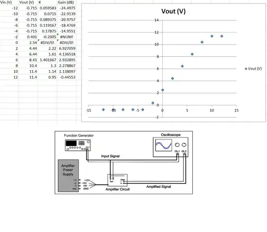

In on of my lab classes, we just dealt with the response of amplifiers to a variable DC voltage source. The lab consisted of DC power supply as the variable voltage source, an amplifier, amplifier power supply, and an oscilloscope. We varied the DC power supply from -12V to +12V in 2V increments and we had to record the output voltages and plot the final results. At 0V there was a offset of 2.54V caused by the amplifier being powered by the DC power supply.
After we plotted the results, the graph of input voltage vs output voltage looked as expected with lower saturation limits, then a linear increase in voltage and high saturation limits. Our results showed an amplification factor (the slope of the linear region) of less than 1, which caused the gain of the amplifier to be negative. My TA said the setup looked fine and could not explain any reasons why we got a negative gain.
Does anyone have any reason as to why the amplifier would produce a negative gain, thus defeating the purpose of the amplifier?

  • Schematic? Pictures? Anything? – Matt Young Sep 07 '12 at 21:54
  • I could post a picture of the results, i tried to explain a schematic as best i could – Greg Harrington Sep 07 '12 at 21:55
  • @GregHarrington Can you draw the schematic? circuitlab.com works well. – Kortuk Sep 07 '12 at 22:22
  • The best picture I could get is the one from the lab manual. Most of the other amplifiers in the class were giving positive output gains – Greg Harrington Sep 07 '12 at 22:27
  • Do you think there could have been any procedural error that could have caused it to be wrong? I did the lab a week ago and can't quite remember if something was done wrong – Greg Harrington Sep 07 '12 at 22:44
  • You say that you vary the DC supply from -12V to +12V, yet in your spreadsheet you seem to list this DC supply voltage as your Vin. I am confused. All the answers provided are instructive but we (I) still don't have a schematic. Is the amplifier powered by a single supply or split supply (i.e. +/-12V)? Are your input and output AC signals or a DC voltage? It appears that Vin and Vout are AC sinewaves, so your statement about varying the DC supply from -12 to +12 makes no sense to me. – gman Apr 17 '13 at 22:46
  • How did you calculate K (which is what I assume you are calling the gain)? From 2V to 4V input (2V change) the output also went up 2V, so you should have a gain of 1 at that step, which is not in your K column anywhere. – Austin May 04 '15 at 19:06
  • I see what you did, K is the output divided by the input. This is not correct, you should be using the changes between each step so that you are calculating the slope of the transfer curve at each point. This would give you a gain of about 0 at the ends and a gain of about 1 in the middle. – Austin May 04 '15 at 19:08

  • Ok I think I am starting to understand the differences. I guess when I meant "negative gain", I meant that I was getting an amplification factor < 1 and then that gave a negative number when I calculated the gain in dB as G = 20*log(K). I always thought the gain of an amplifier should be > 0 and that's why I began to get confused. I didn't mean that the signal was being inverted – Greg Harrington Sep 09 '12 at 03:32
  • I thought it was a problem that i was calculating gain as < 0 but if it means the signal is being attenuated and that's fine with the amplifier then i understand that now – Greg Harrington Sep 09 '12 at 03:34

What you are saying is contradicting itself. You say the graph shows a gain a little less than 1, but suddenly you are saying the gain is negative (less than 0). The gain in the linear region does seem to be right around 1 according to the graph. I can't begin to guess how you got a negative gain out of that, especially since you apparently read the graph correctly.
At first approximation, the gain is 1.0. If you use the numbers from the table from input 0 to 6 V, the gain is 0.98. That is certainly not negative.
Added:
After reading some of your comments, I think you are confused by how you are expressing gain. Gain is simply the ratio of a output response size divided by the input size to get that response. In your case, over the range from 0 to 6 volts in, you get 2.54 to 8.41 volts out. Therefore gain is:
   Gain = dOut / dIn = (8.41V - 2.54V) / (6V - 0V) = 5.87V / 6.00V = 0.98
This is close to 1, meaning the amplifier actually attenuates slightly, but it is certainly not negative.
The problem seems to be that you then express this gain logarithmically, and the negative result confuses you. Voltage gain expressed in dB is 20*log10(gain), which is -.19 dB in this case. Note that logarithmic values, such as dB, will be negative when the linear value (the straight gain in this case) is less than one. In other words dB gives us a scale where 0 is unity gain, negative values represent attenuation, and positive values amplification.
While there is nothing wrong with gain less than 1, and therefore that gain expressed in dB being negative, this is not the same as negative gain. Negative gain means the output is inverted from the input. For the gain to be negative, the output would have to go down when the input goes up, which is clearly not happening in your case.

  • There is a different between gain and amplification factor. My teacher said the amplification factor for this should be the slope of the line between the upper and saturation limits. That slope comes out to be around .95. Gain (in dB) is 20*log(amplification factor). Since the factor is less than one, then the gain is negative – Greg Harrington Sep 07 '12 at 23:17
  • Could I say that the amplifier was defective? – Greg Harrington Sep 08 '12 at 00:43
    Your gain is not negative. What you are calling the amplification factor is gain, expressed as a ratio. What I think is confusing you, is the fact that it is attenuating the signal, rather than amplifying it, which is a perfectly valid function of an amplifier. There may or may not be anything wrong with the amplifier, but we don't have a schematic. My money is on not. – Matt Young Sep 08 '12 at 01:23
  • the slope of the line is .95, making it the amplification factor (K). Gain, in dB is expressed as 20*log(K). Making my gain NEGATIVE. So why do you say it is not negative? – Greg Harrington Sep 08 '12 at 02:41
    Because a negative logarithm is not the logarithm of a negative number. As Olin has stated, "In other words dB gives us a scale where 0 is unity gain, negative values represent attenuation, and positive values amplification." So the fact that the logarithm of K is negative does not mean that the gain (assuming you are referring to K as gain) is negative: it just means that K is less than one. – WhatRoughBeast Mar 15 '19 at 23:13
