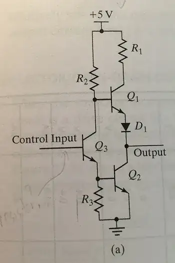

I came across the following circuit in my text book:
schematic image
Summary of the explanation given in my text book: When control input Q3 is low, Q1 is on and output is HI. When control input Q3 is high, Q2 is on and the output is forced LO. D1 is necessary to insure that Q1 is off, when Q2 is turned on. R1 is necessary to limit the transient current when changing states (because bipolar transistors turn on more quickly than they turn off).
I can't seem to figure out how the control input being low or high results in the output states it does. Would someone be able to walk me through the logic? Basically what would the voltages be at the intermediate points between input and output?
Thanks.

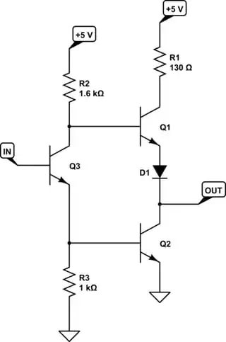

Short Overview
Your schematic is basically this:
schematic
I've added the typical resistor values for TTL here, as well. Just for reference.
The first thing to understand how the input (labeled \$IN\$ in the schematic) is actually driven. The circuit does not stand by itself. The drive will typically either be holding \$IN\$ close to ground (with output HI) so that \$Q_3\$ is OFF or else by sourcing a current of about \$700\:\mu\text{A}\$ into the base of \$Q_3\$ (with output LO.)
With that in mind, let's discuss the two cases.
Output HI
Here is the schematic in the case where the output is HI. I've added some details about how \$IN\$ is actually driven in a real circuit as well as a few short notes here and there. I've also included the equivalent resulting circuit on the right side.
schematic
simulate this circuit
First, look at the circuit on the left side and make sure that you agree with me about which BJTs are on and which are off. Then verify that you also agree with me about the equivalent circuit on the right.
In this state, the output cannot sink any current. You should also easily see that \$R_1\$ provides some high-side current limiting (in case the output is grounded, for example.)
With normally low sourcing currents, the output impedance (given \$\beta\ge 40\$) is about \$\frac{R_2}{\beta+1}\approx 40\:\Omega\$. However, when attempting to force higher sourcing currents by driving \$Q_1\$ into saturation (at sourcing currents exceeding close to \$3\:\text{mA}\$), the output impedance rapidly moves towards \$R_1\$'s value, or \$130\:\Omega\$. (That's actually a desirable behavior; having lower sourcing impedance when operating normally and having the source impedance increase if the circuit is being pushed harder towards its limits.)
(In this saturated case, the only requirement is that the saturated \$\beta\ge \frac{R_2}{R_1}\approx 12\$. Which is reasonable.)
Output LO
Here is the schematic in the case where the output is LO. I've added some details about how \$IN\$ is actually driven in a real circuit as well as a few short notes here and there, once again. I've also included the equivalent resulting circuit on the right side... once again:
schematic
In this state, the output cannot source any current. It can only sink current. And it can sink a fair amount of it, in fact. (Just look at the base current into \$Q_2\$.)
That's about it. If you want more discussion then please refer to the other two posts here I've made on the topic: (1) TTL Inverter and also (2) TTL AND.

When control input is low, Q3 is off, so R3 pulls Q2 base low and turns off Q2.
With Q3 off, R2 drives Q1 base current, turning Q1 on and letting current flow thru R1 and D1 to the output. Output is then 5V - output current x R1 - Vce of Q1 - Vf of D1.
With Q3 on, Q1 is off, Q2 is on, and output is basically Vce of Q2.
If you assume Vbe of 0.5 to 0.7V, and same for Vce, then you can determine the intermediate voltages.
CrossRoads
  • 3,571
  • 15
  • Thanks that helps a lot. I still don't understand the latter case, when Q3 is on. Why would that force Q1 to be off? Wouldn't a current still flow through R2 and into base current for Q1? – user198450 Sep 18 '18 at 17:24
  • No, because the collector of Q3 is only about 1.0V above ground (Vbe of Q2 plus Vce of Q3). This puts the base voltage of Q1 at about the same as its emitter (Vce of Q2 plus diode drop), keeping it cut off. All of R2's current flows through Q3. – Dave Tweed Sep 18 '18 at 17:28
  • Makes sense. Last question, how come Q2 and Q3 don't have resistors to control their base current (like R2 with Q1)? Is that not needed here? – user198450 Sep 18 '18 at 17:35
  • R2 also protects Q2, and R3 protects Q3. – Cristobol Polychronopolis Sep 18 '18 at 17:40
