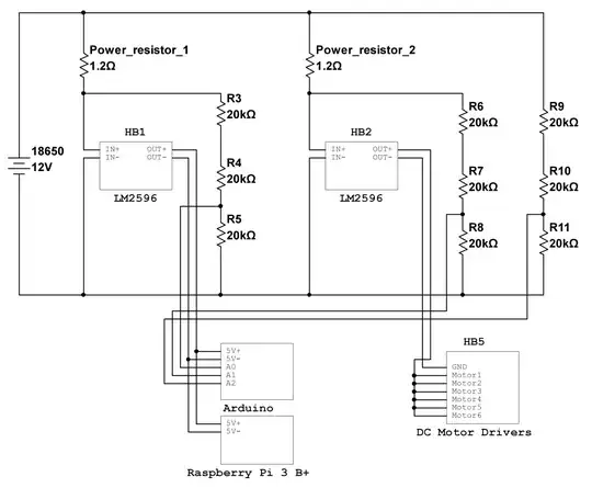

I'm building a robot which contains a battery system. The 3x18650 batteries are connected in series and are charged using TP4056 boards. The voltage is then fed into the circuit shown below. The voltage dividers and power resistors assist in obtaining the voltage and current of the system.
My questions are:
  1. Is connecting the batteries in series while charging a bad idea?
  2. The buck regulators have a maximum current output of 3A, that is why im thinking of connecting two of these boards in parallel to share the load, is it safe to do this?
  3. Any thoughts of improving the system.
  4. What is the simplest way to get the Arduino to know if the batteries are being charged or not?

Your LM2596 will not generate split +/-5V supplies. Yes, it is true the intermodulation or having each Buck supply interference with simultaneous charge currents is not a good idea.
Although it is a good idea to decouple the motor power from logic Vdd and Vss but not with this PS design. Go to ti.com and register your email and choose a triple output design from their "Webbench" online in the browser with Java approval or Analog Devices.
Often a 3 secondary winding forward converter works best on a custom coil form. By tight mutual coupling of coils, the ratios of voltage are maintained while regulating off one for feedback. This is how PC PSU's generate all their voltages.

  • the regulators are buck converters which use switching to regulate voltage. They give 5V output. I did not choose linear regulators because they waster power which is not good for battery powered system. Because the buck converters work by switching, i was wondering what if i used two in parallel, because some say its not safe – Ibrahim Timimi Sep 16 '18 at 23:12
