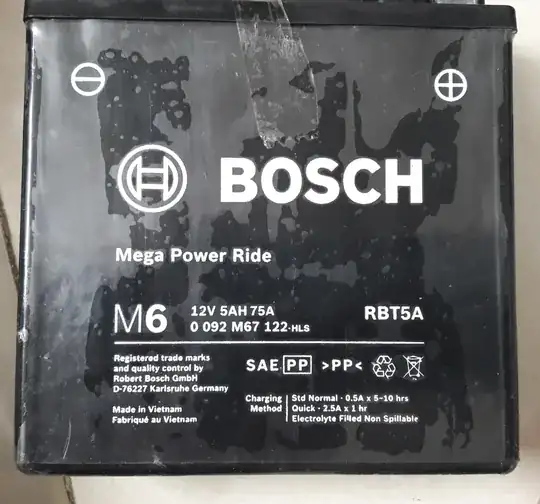

I just bought this battery:
Specifications of Bosch motorcycle battery
So what does the 75A mean? How do I get the same parameter "10hr" that appears in this question: Whats does "hr" mean among "V" and "Ah" in batteries?

The 75A is the rated current the starter may draw for a few seconds without damaging the battery.
There's no discharge rating printed on the battery. Bosch usually uses a 20hr rating for the capacity, it seems. At 10hrs, it's 90% of the printed capacity.

    My suspicion, offered without proof, is that 5AH might well mean 5 Amp Hours. – Scott Seidman Sep 13 '18 at 17:12
    Yes, at 20 hours discharge duration. That's what Bosch uses for their other sealed lead batteries. I haven't found the datasheet for this one, unfortunately. At 10 hours, they derate to 90% of the printed capacity. – Janka Sep 13 '18 at 17:14

    @Misunderstood: the Bosch RBT5A is a motorcycle starter battery. It even has a motorcycle on the cardboard box: https://vn-live-02.slatic.net/p/8/binh-dien-ac-qui-kho-danh-cho-xe-may-bosch-rbt5a-1478778149-2818003-7f533350ea2481fb2296860ecfc43680-zoom.jpg – Janka Sep 13 '18 at 21:59
  • Yes I see it is being sold in the Philippines for scooters and mopeds. I believe it is general purpose SLA battery that will work for motor scooters. CCA means how many amps it can deliver for 30 seconds at 0°C. I still believe it is manufactured as as a general purpose deep cycle battery. A quality 5AH deep cycle should be able to source 75 amps for a few minutes minutes at 0°C. I would need to see a datasheet to confirm. For now I will retract because I cannot prove this particular battery would work as a deep cycle. – Misunderstood Sep 13 '18 at 22:36
  • AGM is usually meant for deep cycle. On motorbikes, however, they use it to overcome the problem with tilting the bike. That was the main reason motorcycles had no batteries until the late 1970ies. (And those "sealed" wet batteries had been always a mess.) – Janka Sep 13 '18 at 22:40

  • Yes, you are correct. I found a brochure that specifies 75 CCA for the RBT5A. – Misunderstood Sep 14 '18 at 02:44
A battery of this size is classified as a power sports battery. CCA is not applicable to powersports batteries. A small single cylinder engine (≈120cc or less) uses a low torque starter motor that takes like 20 amp to turn over.
The Bosch M designation, in M6, is for Marine. Marine batteries have a dual role as starter and deep cycle. Bosch no longer sells an M6 battery but still sells an m4 and M5 as marine batteries.
Bosch only sells Li-ion powersports batteries and no longer sells a powersports SLA battery, except in third world countries and began marketing them in Indonesia in 2017. It was confirmed this is a rugged general purpose deep cycle battery. In this capacity it does not make sense to manufacture a deep cycle, marine, and powersport when one battery covers all markets.
Some retailers have standard tables for lead acid batteries which includes a row or column for CCA. They will use the deep cycle's max current as the CCA because technically the battery can supply 75 amp for 30 seconds, much longer actually.
I also confirmed that AH rating is no longer used for automotive batteries. Car batteries sold in the US only have CCA and Reserve Capacity (RC) is the number of minutes a fully charged battery at 80°F will discharge 25 amps until the battery drops below 10.5 volts. I also confirmed this by buying a Duracell Ultra (SLI-78M) truck battery. The only specs on it are CCA (800) and RC (115 minutes).

75A means this is the maximum discharge rate that will not damage the battery.
This battery is likely not a motorcycle starter battery but rather a deep cycle. This appears to be for a lightweight electric vehicle like a kids car. 5AH is not much capacity for a Sealed Lead Acid (SLA). The batteries used in a golf cart will typically have at least 100 Amp Hour capacity.

  • @Misunderstood Since you've done some research into these Bosch batteries, were you able to find a datasheet? 75A can mean one of two things. (1) If this is touted as a starter battery, then this is cranking amps. (2) If this is a touted as a deep cycle battery, then this is the current at which is achieves its capacity (Ah) rating. Capacity is current-dependent: at lower current a battery has a higher capacity. Having said that, it looks strange that a deep cycle battery would be rated at a current which it can sustain for only four minutes. – Nick Alexeev Sep 16 '18 at 02:15
    @NickAlexeev It is rated at 5 AH with no CCA. This reserve capacity is generally done at 0.05C for 20 hours. That is why the RC was changed to minutes at 25 amp for starter batteries. The max current is 75 amp generally measured a 3C, which will not damage the plates of a deep cycle SLA. No, I could not find a datasheet so I called Bosch in Illinois. Read the link in my update. It confirms what I said is true as well as the manager of Batteries+ and the rep at Bosch. – Misunderstood Sep 16 '18 at 02:44
