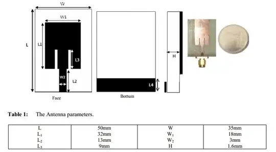

There seems to be a remarkable lack of relevant on-web material. Maybe just hiding.
This looks highly apposite Design of New Multi Standard Patch Antenna GSM/PCS/UMTS/HIPERLAN for Mobile Cellular Phones with an interesting appearance

The free marvellous NEC RF software will probably do what you want.
Links and intro to NEC here
Have a look here RF/Microwave Tools and here Tools and calculators - with RF writ large
If you have enough $ - Agilent ADS
