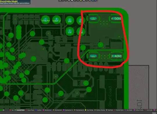

I'm new to Mixed-signal design and I'm having trouble deciding how to connect my digital and analog ground. I'm doing a 4 layer design, so I have a split ground plane.
As I understand, since I'm using the same supply the grounds should get together at some point. I'm inclined to use the USB shield as that point where the grounds come together, as I think this would clearly define the returning paths for the digital and analog currents.
I'm not sure if this is a good practice, or if there is a better solution.
I'd be glad to get any feedback on this. Thanks!
Edit: This is not a high frequency design (the main Microcontroller works at 16 Mhz). The different planes are required as the manufacturer states it as a requirement in the datasheet. The power comes from a USB connector that lowers the voltage to 3.3V through a regulator ADP3333. From there I get the "digital power" which comes directly from the regulator and then I get the "analog power" which is the regulator output passing through a ferrite bead.
The IC is Analog devices AD5933 network analyser. http://www.analog.com/en/products/ad5933.html
Re-edit: My main question is:
Is it ok to connect both grounds through the USB chasis? Like this? enter image description here

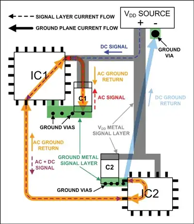

  • What manufacturer, for what chip/circuit? Do you have a Schematic? Generally speaking the place to combine grounds is directly at analogue regulator. In general I'd just combine the grounds and pay attention to your return currents. You can make a "moat" in the ground plane around your analogue circuit to force high speed current spikes to go around. – Barleyman Sep 13 '18 at 23:33

  • @Barleyman the manufacturer is Analog Devices and the IC is the AD5933 network analyser. I have a ground moat around my digital signals as you suggest and I'm combining both grounds using the USB chasis which is close to the voltage regulator. – DCrown Sep 14 '18 at 13:07
  • It's pretty easy to shoot yourself into the foot with creating splits in the ground plane. Check this for example: https://www.maximintegrated.com/en/app-notes/index.mvp/id/5450 Usually a "moat" would actually look like a horseshoe and go around analogue part to keep the digital return currents away. If you put it around the digital part, the high frequency return current noise will (still) take the shortest route to a power source which may cross your analogue bits. Also, never ever cross a gap in ground plane with high frequency line! – Barleyman Sep 14 '18 at 13:18

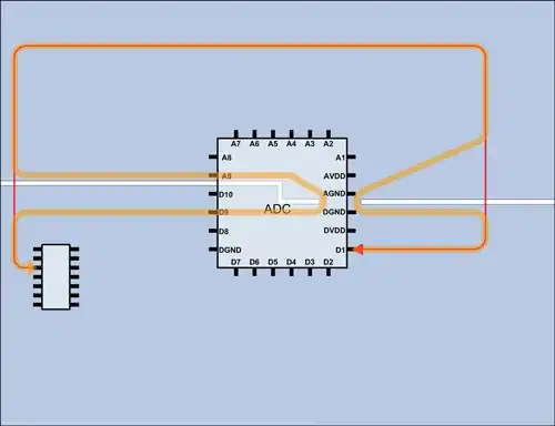

Never ever cross a gap in ground plane with high frequency line! Your layout has several traces going over the gap.
Usually a "moat" would actually look like a horseshoe and go around analogue part to keep the digital return currents away while allowing analogue currents to pass normally. If you put it around the digital part, the high frequency return current noise will (still) take the electrically shortest route to a power source which may cross your analogue bits.

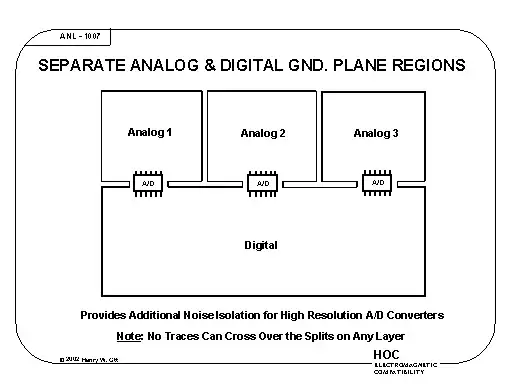

Here's an idealised situation where the AD circuits are all on the same edge. But it'd work the same even if they were in the center of the PCB, DGND would extend all around. Just imagine the image border is in fact your digital ground plane edge with the AGND squares carved out of it.
Actually that image would lend itself into a simple partitioning.. http://www.ti.com/lit/an/slyt512/slyt512.pdf

Basically you have created this situation, digital traces going over ground gaps is not nice.
Don't forget you've got several layers to play with. Move digital GND copper to the other side of the board, next to bottom layer. Put digital traces on the bottom layer and now you have nice solid return path for the high frequency noise. Or vice versa obviously.
