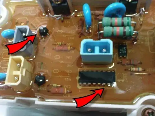

Great to be doing stuff like that at this age!
I think the previous answer did not address the question which was how to insulate PCB trace.
If you circuit runs 220V you probably want to put it inside a plastic box.
You can also insulate it by putting coating the trace with resin like epoxy or you can put the whole circuit inside silicone
There are also some spray to do so
pcb covered with silicone.
Damien
