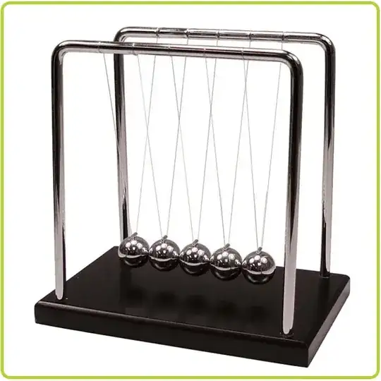

By analogy, consider the "Newton's cradle" desk toy:
The signal moves through the balls faster than the ball itself.

    That's great analogy, I didn't know that! But the question remains, do the electrons journey? Or they go back like the balls? – Markus von Broady Sep 04 '12 at 19:29
