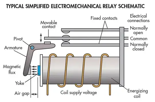

Figure 1. Source: Machine Design.
The relay coil, when energised, pulls in the armature to actuate the contacts. Since the coil is powered by alternating current the magnetic field collapses to zero at each mains crossing and the armature tends to start to release. Its inertia is high enough that the contacts remain actuated long enough to maintain contact through each zero-cross of the mains.
The buzz is normal. It is caused by the vibration of the armature on the yoke on each half cycle.

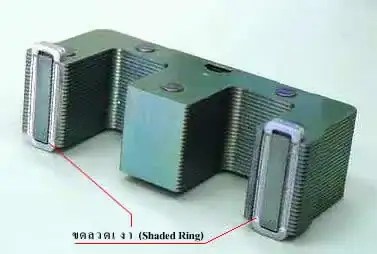

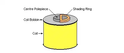

AC-coil relays use a shading ring that helps smooth out the force from the varying field. Photo from this website.
The shading ring acts as a shorted turn that causes an out of phase current so the total field does not drop to zero. It still varies though.
It's normal for AC-coil relays to hum acoustically at a multiple of mains frequency. They can excite resonances in mechanical bits causing the noise to become objectionable. Large industrial contactors can make quite a racket.
