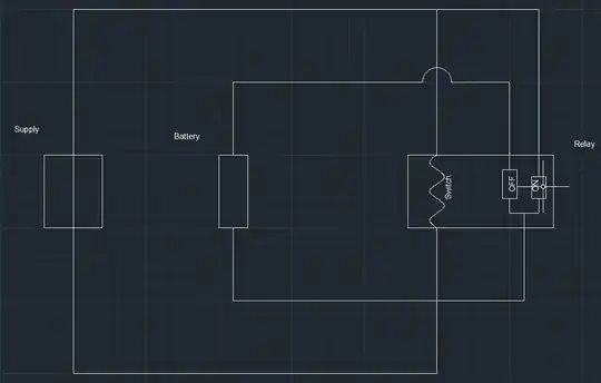

enter image description hereI know this was posted half my life ago, but whatever. Seems like a great use of a relay. Connect the relay so that your main power source is connected across the relay trigger and the relay-on output. Then you can connect the batteries to the other relay terminal. If the main source goes out, the relay will switch off, connecting the batteries to the load. The relay just keeps the two circuits separated so you don't have to worry about the sources' interaction. Just put a couple current limiting resistors wherever needed and it should work fine.
