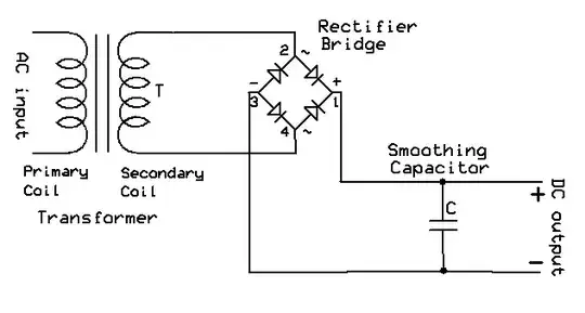

The image above shows how a typical AC to DC adapter works, high voltage (230V) at low current is fed into the primary coil and then gets stepped down to a lower voltage with higher current, afterwards it gets rectified to DC and finally a capacitor turns this DC to pure DC.
The power from the primary coil has to be the same as the power at the secondary coil (assuming no power loss). Let's for instance use an example, a phone charger, most phone chargers normally output 5V@1A DC which means 5W. Since the voltage from the wall is 230V this means that for there to be 5W there has to be 5W/230V = 0.0217A which means that the resistance at the primary coil is 230V/0.0217A = 10599\$\Omega\$
This is the part that I don't get, how can an inductor (coil), something with almost no resistance, have so much resistance. At first I thought that they would put a resistor before the coil but then I figured out that all the power would be used up by the resistor and wasted as heat instead of reaching the coil.
So what is really going on? Do they make these coils with materials that have really high resistance or am I missing something? Probably the latter is true.

You are over-complicating things by thinking about a transformer plus bridge and capacitor. Think about just the transformer with nothing connected to the secondary. Then, after thinking about it you should realize that if the secondary is not connected to anything, it can be removed. This leaves you with the primary connected to your AC mains circuit and that primary is now just an inductor.

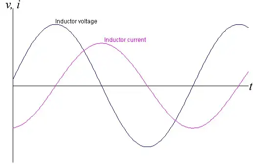

So, if the inductor is (say) 10 henries in value, it will have an impedance at 50 Hz of \$2\pi f L\$ = 3142 ohms and will take a current of 73.2 mA when the applied AC voltage is 230 volts.
Additionally, because this current is created by the inductance of the primary, there is no power associated with it i.e. the current waveform is lagging the voltage waveform by 90 degrees: -

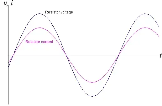

If it were a resistor of 3142 ohms the current would be in-phase with the voltage thus: -

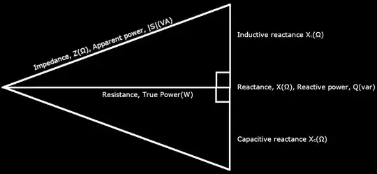

Impedance and apparent power triangles
You can see the mathematical relationship between the different "types" of resistance and the different "types" of power in the diagram. Using trigonometry and pythagorean theorem, you can use two sides of the triangle or one side and an angle to calculate the other values. You use a right angled triangle with reactance pointing upwards for inductance and downward for capacitance. Resistance and reactance, respectively, are the horizontal and vertical components of impedance.
If you have multiple devices of varying impedance like a two different motors or a motor and a capacitor bank in series, and you want to add up their values and find out how much current will flow, you can't just add up the values like you would with resistance if the angles don't match. Instead you must find the resistance and reactance values, add them, and calculate the value of the resulting vector.
The angle between power and apparent power is referred to as power factor angle, it is the cosine of the power factor, which is power/apparent power.
