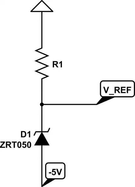

The other option I see is a shunt regulator. I didn't find any with a fixed reference voltage of 0.1V-0.2V, so the suggestion in this answer https://electronics.stackexchange.com/a/383440/197145 does not work. I did find a 4.9V reference (Diodes ZRT050) though, which could be used like this:
schematic
However, this way (if it works?) the reference voltage is established with respect to the -5V power supply instead of GND, so I fear to get the same problems with noise and transients as with the op-amp solution.

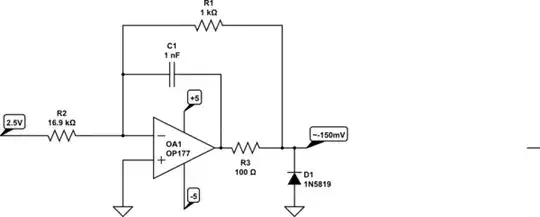

The reference inputs are low impedance, typically 5K ohms, so you should drive them with low impedance sources.
The easiest approach is to use an op-amp from your existing positive reference voltage. I'll assume that's 2.5V here. If it's something else, just alter R2 appropriately.
You can choose an appropriate op-amp to meet your purposes.
schematic
The output voltage is -Vref*(R1/R2)
R3, D1 prevent the output reference voltage from going too far negative, even during transient conditions. C1 enhances stability.

  • Inverting opamp from 2.5V reference (which I indeed have) is a great idea. Can you briefly explain the role of Diode D1? – Peter Power Aug 29 '18 at 10:57
  • D1 conducts if the output goes more than a couple hundred mV negative under any conditions. This is to protect the DAC which shouldn't have the input driven more than a few hundred mV beyond the supply rails. – Spehro Pefhany Aug 29 '18 at 11:08
