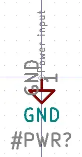

To examine grounds in KiCad, let's open the standard GND symbol in the Symbol Library Editor.
GND Symbol
There are a few things to note here. First, all of the grey text are marked "Invisible" in the schematic, so you will not see them by default when you place the symbol.
  • The #PWR? is the symbol reference. By prefixing it with #, the symbol is not added to your Bill of Materials. The ? is not part of the reference string (you will not see it when editing the reference). It is a placeholder to denote the unique number that will be assigned during schematic annotation depending on the other #PWR symbols in your schematic.
  • The pin on the symbol is pin number 1 and is labeled GND. Because it is an invisible power input pin, KiCad will create a global label for it. The global label will be named GND as that is the name of the pin.

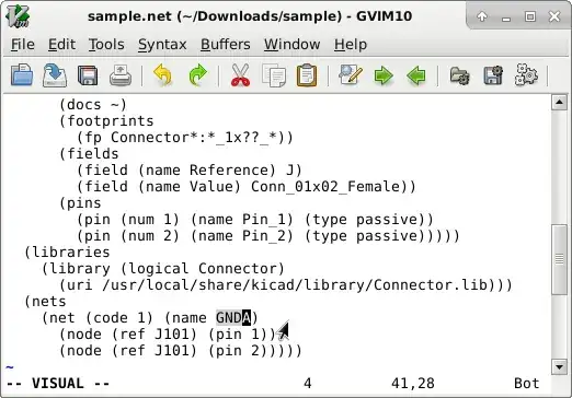

Then, KiCad will recognize this as a single net with two labels (GNDA and GNDD). In your netlist and by extension pcbnew, KiCad will choose GNDA for the single net label because it is alphabetically first.
Netlist of Joined nets

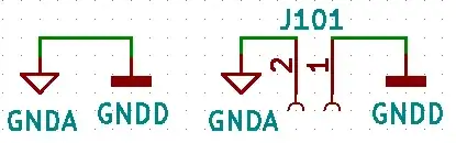

If you want to keep the two nets distinct in your layout and only connect them with a net tie, then you need to set up the connection in your schematic to look like this:
Net Tie Schematic
Placing the net tie between the two nets tells KiCad that you want two nets with a single connection between them.

  • Wouldn't this mean that you've both the net tie, and the 2-pin header (J101) on your PCB? – Neppomuk Jan 01 '22 at 22:47
    @Neppomuk Yes.. – Seth Jan 02 '22 at 15:36
