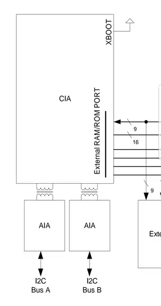

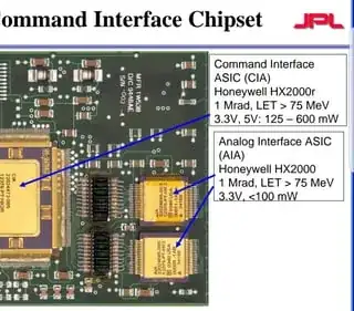

In addition to having two redundant I2C busses, each device has a custom ASIC that provides isolation between the bus and the main chip pictured here  and here . Is this chip perhaps providing some kind of conditioning as well?
