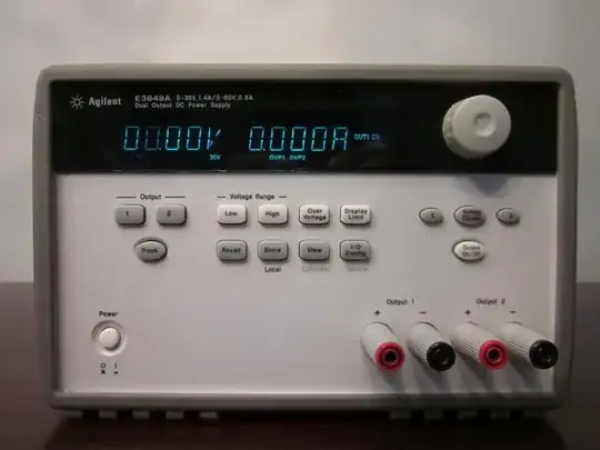

I've been using a power supply with both COM and earth ground, like the first image below.
To power an op-amp, I was using COM for grounding.
Then, I came across a power supply like the second image below, which doesn't have COM.
Also, I've seen a power supply with no ground port whatsoever like the third image below.
I heard the earth ground is noisier. Why do some power supplies have both COM and earth ground, but others don't? And if I have to use one without COM or no ground port at all, what are my alternatives?

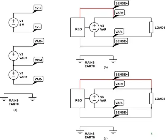

schematic
Figure 1. Various options.
Photo 1
  • The first photo shows a PSU with configuration of Figure 1a. There are two isolated supplies - isolated from each other and from mains earth.
  • Normal use would be to connect 5V- to COM and now you would have a dual variable supply for the analog electronics - typically +/-12 V - and a 5 V supply for the digital logic.
  • If the circuit requires mains earth for any reason then connect the green post to the relevant point. Typically this is the COM.
Photo 2
  • This power supply has remote sense inputs. These allow the power supply to compensate for voltage drop in the wires to a remote load.
  • If not required then wire as shown in Figure 1b. Note the shorting links in your photo.
  • If remote sensing is required then open the links and wire as shown in Figure 1c. The voltage between the + and - terminals will vary with load but the voltage across LOAD2 should remain at the setpoint.
  • Again, if an earth reference is required then this can be achieved using the green post.

So if i were to use a power supply with remote sense inputs, and if i went to use it like the first power supply with COM, i would connect what would've been connected to COM to the green post.
I think you are confused. The Photo 2 PSU has only one output with + and - terminals. It is not a dual supply as shown in Photo 1. You can think of it as a variable voltage battery with an optional earth connection. You always connect the load to red and black and add an optional link from either to the earth terminal.

  • Thank you so much for your in-depth explanation. So if i were to use a power supply with remote sense inputs, and if i want to use it like the first power supply with COM, is there a way to use the 2nd type like the 1st type?. – Blackwidow Aug 25 '18 at 17:16
  • See the update. – Transistor Aug 25 '18 at 17:23
  • My apologies, I did not phrase my question correctly. I am trying to run a transimpedance amplifier I made on a protoboard. I need +15, -15V to power the op-amp and also ground the positive pin. If I had the 1st type of power supply, I would just connect COM to the positive pin. What if I only have the 2nd type of power supply though? (without COM). Would I still be able to run the circuit? (It seems not) – Blackwidow Aug 25 '18 at 17:26
  • @Blackwidow: You can use the third unit as a +/- supply - connect the + terminal of one supply to the - terminal of the other, and use that point as "common". – Peter Bennett Aug 25 '18 at 17:28
  • @PeterBennett Thank you. I think it makes perfect sense now. What happens if you just connect mains to the + pin of the op-amp and connect +,-15V to power the op amp I think I just destroyed the op amp. Since mains isnt connected to anything else, I am not sure what actually happened to the op-amp when I pretended mains (the green port) was the ground that the + pin was supposed to connect to – Blackwidow Aug 25 '18 at 17:32
  • It's time to draw a schematic. Maybe ask a new question. I've modified my Figure 1 to refer to "MAINS EARTH" rather than "mains" to eliminate any confusion. You shouldn't be mixing mains voltages and op-amps. – Transistor Aug 25 '18 at 17:39
  • I've updated Figure 2 to explain further. – Transistor Aug 25 '18 at 17:47
  • @Blackwidow: For most electronic experimentation, you don't need any connection to an Earth Ground (or Mains Ground). The "Common" connection of your dual supply will be the circuit Ground. The term "Ground" is much misused in electronics - in most cases, it just means the point in the circuit that you consider as "Zero Volts", and has no relation to the mains wiring ground. – Peter Bennett Aug 25 '18 at 18:26
The first supply has a bipolar output - effectively, a positive supply and a negative supply share a common pin.
The second unit is a single supply with remote sensing connections. Neither supply terminal is connected to Earth so it can be used as either a positive or negative supply.
The third unit has two separate supplies, each with neither terminal grounded, so the two supplies may be connected in series, for a bipolar supply, or used independently.
