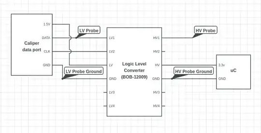

I'm trying to convert 1.5V logic levels from a caliper data port to 3.3v to be able to read it with a microcontroller, using one of the sparkfun logic level converters. The product page mentions it can be used for 1.8V logic levels, so I was hoping 1.5V would work as well.

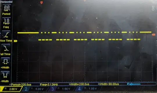

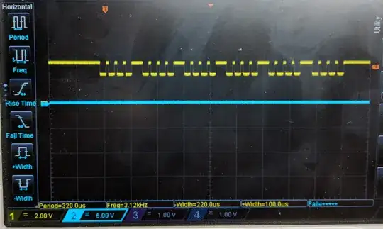

When I look at the waveform generated on the HV side, the high logic level is at the expected voltage, but the low logic level is much higher than expected, and I'm not sure why.
Interestingly, if I connect the LV side directly to the ground and 1.5V from the caliper's data port, the HV side shows 0V and 3.3V as expected
I have it hooked up like so. Note: the probe was actually connected to the CLK pin on both sides (LV2/HV2), not the data pin as shown. Although I got similar results when looking at the data signal.
And here are the traces from the LV side and the HV side.
(LV) enter image description here (HV) enter image description here

  • Well, if this part of yours produces its own clock then there is no telling what output signals it uses. It's "0" output could be not low enough to fully close the FET. I can't tell from the scope what it is. – Maple Aug 18 '18 at 22:02
  • The low logic level is approximately the same voltage level as the ground level on the port. the little yellow "1" arrow on the left of the LV image shows the ground level. – JesusFreke Aug 18 '18 at 22:08
If level converter works when you directly connect LV input to GND or 1.5V and does not work from DATA/CLK pins then it means logic levels on those outputs do not have enough swing to switch the FET. Or maybe do not have enough sink capability.
One possible workaround is to reduce pull-up strength on that adapter board from 10K to 22K or more (on LV side only).
However more reliable solution would be to use different level shifter, something that does not depend on Vgs of the MOSFET and has high input impedance. Like PCA9306 for example.

  • I took a break from this project for a while, but just took it back up. I revisited this, desoldered the pull up resistor on the HV side and replaced it with a 22k pull up, which did improve things, but not quite enough. I replaced it with a 100k pull up and the swing was much wider, nearly rail to rail. The low voltage level was at around .1V or so. – JesusFreke May 07 '19 at 04:48
  • Looks like your solution with opamp was the best and simplest, after all. – Maple May 07 '19 at 16:30
  • Hmm? Decreasing the pull-up strength as you had suggested worked. I just had to decrease it a bit more than suggested. The slew rate suffered with the higher pull-up resistance of course, but it's a slow enough signal that it's still acceptable. – JesusFreke May 07 '19 at 20:14
