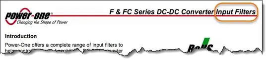

Figure 1. From the datasheet.
No you're not. That's in input filter for a DC-DC converter. From the datasheet:
Power-One offers a complete range of input filters to help control EMI in board-level DC-DC converter applications.
The voltage rating will tell you the maximum voltage that the filter can withstand between positive and negative lines.
The current rating is the maximum current that the device can handle through the filter.

  • Thank you. I didn't realize this. I thought it was a converter based off the description "Isolated DC/DC Converters 0-100Vin 5A 1500VDC Isolation". – ElectroMotiveHorse Aug 09 '18 at 18:35
