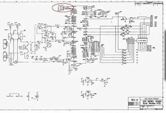

It seems to be used in old modems (up to 2400 baud it seems). I found several links describing the contents of old 2400 baud modems, and they all list such a crystal as component. But unfortunatley I have not found a circuit so far.
But I cannot see which target frequency it can create which a 12MHz crystal cannot (after all, 12MHz divided by 5000 is exactly 2400). I think the reasons are somewhere buried in the ancient modem standards (V.22bis and earlier), but for this you need someone who knows them by heart...

Failure report:
So near, I thought, but still no cookie :-)
Manual and actually readable version of that circuit here but still no real clue. Note that crystal MAY be operated in 3rd (or other) overtone mode.

  • This doesn't seem like an answer, but figuring out how you tell the modem chip that it has a 12.000393 MHz crystal instead of a 16.000312 MHz might lead to a discovery. If this were a movie, there would be a quest to track down the guy who designed it... – Chris Stratton Aug 28 '12 at 18:01
  • @Chris - Not an answer, but it confirms the trend of the other answers (including your deleted one): this clearly is a modem thing! – stevenvh Aug 28 '12 at 18:12
  • The RC224AT data sheet has this on page 2-12. For each baud rate, the baud rate generator is programmed accordingly. A base frequency of 115200Hz is used, so with the 12MHz crystal, instead of a divider of 48 for 2400 baud, a divider of 36 must be used. – hli Aug 28 '12 at 18:13
  • @ChrisStratton - "This doessn't seem ..." -> That's why it's headed "Failure Report". The aim was to be useful. I added it as it adds to the body of knowledge so far, demonstrates where in a typical circuit such a xtal is used and provides a complete commerical modem circuit using one. A bit hard to fit into a comment. Sure, I could have left off the image, but it informs people well enough without having to dig. et al. Whatever. – Russell McMahon Aug 28 '12 at 19:08
  • Since there are many other modem implementations out there (even for the same V.x standards) which use proper frequencies (meaning with integer dividers to the desired frequencies), I think it has more to do with the actual implementation, instead of being a general requirement. It might be that it requires the clock signal to be slightly out of sync with the processed signals (e.g. you sync on a start frame, and when the next start frame arrives you are in the middle of a clock period, and not on a clock edge). But this also is just a guess. – hli Aug 28 '12 at 20:11
