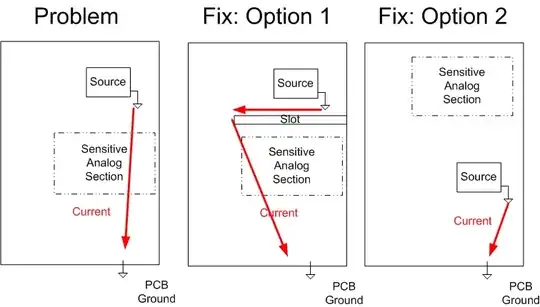

Once, I had a return current running through a sensitive analog section, and it was causing my signal to shift by 10%. The source was from a circuit 'above' the analog section; the path of the return current on the grounding plane needed to change. There are two options:
1) Put a slot in the board and redirect the return current around the section that I wanted to protect. 2) Rearrange the components
illustration of the problem described and the two proposed solutions
I went with option 1 because I didn't have time to rearrange the board, but slots have consequences. Option 2 would have avoided the use of a slot, the slot was short anyway, and I didn't need to run any traces across it.

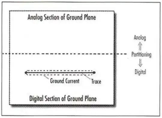

A good board layout will divide the sensitive sides from the noisy sides with physical layout and keep the planes continuous.
diagram suggesting partitioning boards into analog/digital sections
Source: https://www.autodesk.com/products/eagle/blog/everyday-app-note-successfully-design-mixed-signal-pcb-partitioning/

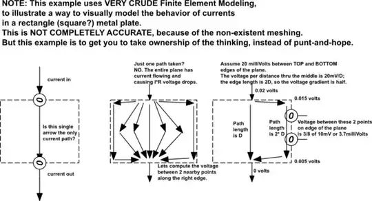

A plane has problems. Example
schematic

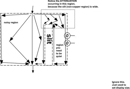

When you expect certain (hopefully nearby) nodes of the Ground Plane to have ZERO volts between those two nodes, that will not happen. Slits can be your friend, to reduce the interfering currents passing along the path between your two sensitive nodes.
schematic
simulate this circuit
Take a copy of the schematic, printed out, and draw ALL the ground currents. Label their values and frequencies and edge-rates. (inductance may matter).
Now start planning how to keep the noise currents away from the GROUND nodes of your sensitive (feedback voltage dividers) circuits.
Note how WIDE slits provide more attenuation of bothersome currents.
My thinking on planes, tho I've done many fast circuits on planes at moderate fidelity, concerned the need for extreme fidelity for audio/music signals and for low-frequency 20/24 bit measurements. Thus LOW FREQUENCY thinking.
