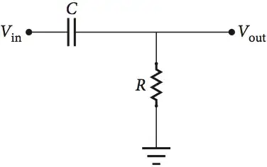

The analogue outputs from this chip will have a DC voltage of approximately 50% the DC supply voltages so that the output can produce superimposed AC waveforms without unreasonably clipping.
This is standard for most electronic audio chips and most signal processing chips. You need to connect to an amplifier using a DC block circuit so that the resulting signal is centred around 0 volts: -
The capacitor value would be a few micro farads and the resistor would be about 10 kohm.
If you can provide more details of the Yamaha chip (i.e. a data sheet link) and explain what amplifier you are considering, closer values can be obtained.

  • I've been using a LM741 as a buffer for the signal and not put too much strain on the DAC. I'm considering using a LM386 as that seems to be what a lot of people seem to use / prefer for a project like this. The way I've been connecting the audio signal to the LM741 is just using a 10k pulldown resistor in parallel to ground and the signal just goes into the non-inverting input after that. I think I had tried putting a capacitor in series with this when I was looking things up but I'm pretty sure it was electrolytic. Does the type of cap / polarized v non-polarized make a difference here? – TokyoScarab Aug 03 '18 at 20:29
  • Use a non polarised capacitor and post the circuit including power rail information. – Andy aka Aug 03 '18 at 20:38
