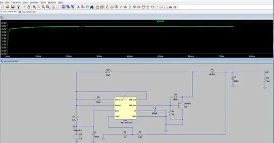

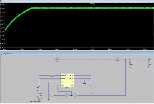

Here is a picture of an LTSpice simulation of a very basic MC34063 step up circuit which is behaving exactly as it should, 5V in 9V out.
I'm trying to adapt this one step at a time until I end up with a circuit featuring multiple isolated outputs with an overall current rated higher than the 1.5A of the MC34063. My next step is to add an external BJT which I've done here :
The real change, aside from the BJT, is that the inductor is now taken out of the MC34063 Switch Collector input, because the collector of the chip is only used to fire the BJT.. and the Inductor is now in the collector of the BJT, so it can get more current.
But as you can see, the output of this circuit gives me 5V ish. The switch is firing as you can see from the ripple.
What obvious thing am I missing here?

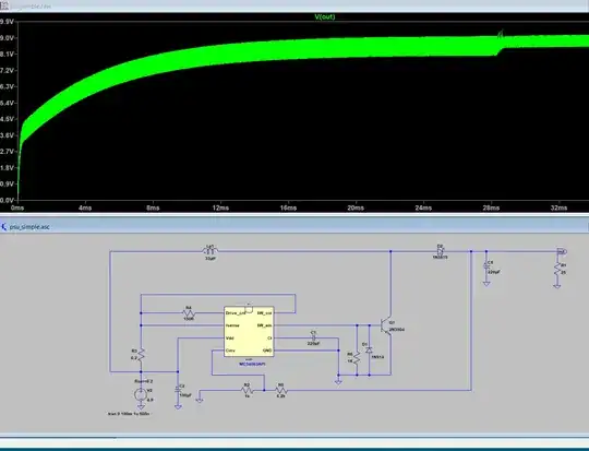

After changing to NPN transistor and increasing the load a little, I get this. It seems this particular transistor can sink some 300mA before it has a wobble. Next step is to add the FET. When I get that working I'll post it here because I've seen nowhere on the internet in which a full MC34063 step up of this kind is properly documented.
Thank you everyone for helping me.

    Can you explain to me how the emitter of the NPN transistor inside MC34063 IC is able to turn on your external PNP transistor? Add an N-Channle MOSFET afte your PNP emiter (mosfet gate)\ – G36 Aug 02 '18 at 15:40
  • That's a good question... can you explain it to me, I'm clearly missing some sort of route from the chip's emitter to ground? Yes the step after this is to add the FET, but I wanted to start with just a transistor. Am I think what you're saying is that I'm missing some sort of route from – Richard Aug 02 '18 at 15:45
    So replace your external PNP with a NPN transistor (emitter to GND, collector to the inductor). Do you now how NPN and PNP transistor work? – G36 Aug 02 '18 at 15:47
  • No, not really. My understanding is that they pass current in opposite directions? How will swapping for an NPN work? – Richard Aug 02 '18 at 15:54
  • Your edit - please look at the circuit in my answer and note that the internal collector goes to the inductor in this configuration. At the moment you are dumping hundreds of mA into the base of the external NPN. Basically, internal and external BJTs are wired as a "Darlington". If you do choose an external NFET then it's OK to leave the collector on the incoming supply after the current limit resistor but please don't blindly assume! – Andy aka Aug 02 '18 at 16:39
In short, to open a PNP transistor you need the voltage at the base to be lower than the emitter voltage (forward bias the emitter-base junction). And the base current need to flow-out off (leave the base terminal) the base terminal (PNP need a path for a current to "GND".)
On the other hand in NPN transistor need to forward bias the base-emitter junction. The voltage on the base must be larger than the voltage on emitter for about 0.6V. And base needs to flow into the base terminal.
Now in your present circuit, you have this situation:
schematic
Now exam what is going on with the PNP transistor first.
As you can see the emitter is at the higher potential than the base terminal, but there is no path for a base current to "GND" (lower potential). So the PNP is OFF (Cut-off).
But if you replace your PNP with an NPN everything will work.
Why?
Because now we have the path for a current from Vcc to the base terminal.
So the NPN transistor can be open and so the collector-emitter current can now flow.
Look here at page 6 https://www.onsemi.com/pub/Collateral/MC34063A-D.PDF (figure.10)

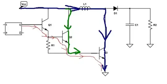

    Q2's collector in your last diagram MUST now go to the inductor to form a Darlington else you get a whopping base current and likely destroy the external BJT. It's all shown on page 6! – Andy aka Aug 02 '18 at 16:41

Prior to the change the internal transistor had emitter to ground and collector to the inductor. That worked.
After the change you tied the internal collector to the power rail and used the internal emitter. Instantly that introduces an inversion in the switching that MUST be countered by using an external transistor that inverts i.e. has it's collector to the inductor but you have used an emitter follower.
Basically, it needs an inverting transistor added and not a voltage follower.
See this in the data sheet: -
The left hand diagram shows a booster (step-up) circuit using an external NPN that inverts (collector out).
