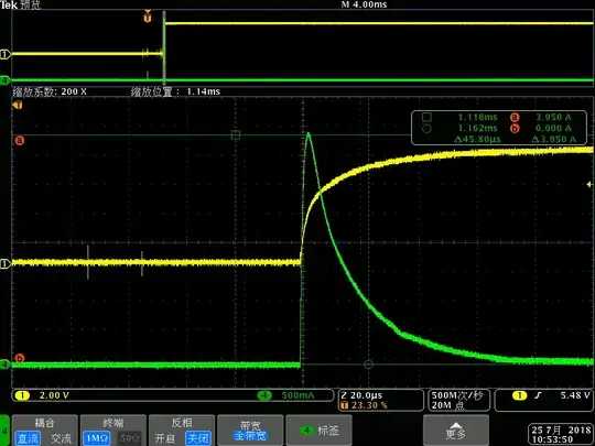

I measured the surge current of the capacitor when it is powered on by the battery, and it is up to 4A as the following screenshot shows.
Yellow - The voltage of the capacitor, Green - The current of the capacitor
oscilloscope trace
I guess the surge current may be the reason for the burning out, but I cannot find any data about the maximum surge current the capacitor can withstand.

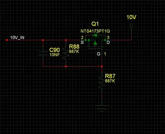

If you can redesign your board, you can include a slow-start circuit such as this one. This will allow you to use either type of cap with little to no risk. Play around with the RC constant to set the speed the MOSFET turns on.
Note that the circuit will probably need an ESD diode on the incoming voltage, assuming it connects to an exposed connector. The FET itself has very little ESD tolerance.

  • At first I plan to use MLCC to replace the tantalum. But maybe you know that MLCC market , especially the large capacitance MLCC, has been suffering from a tough supply time period recently that may take several years to be resolved. So I have to continue with tantalum, and I guess the soft-start circuit you mentioned may be the only option left. – Wanghz Aug 02 '18 at 01:30
  • It's always frustrating when design choices have to be made on an availability basis instead of an engineering basis, but I think that circuit will serve you well. – jalalipop Aug 02 '18 at 13:29
